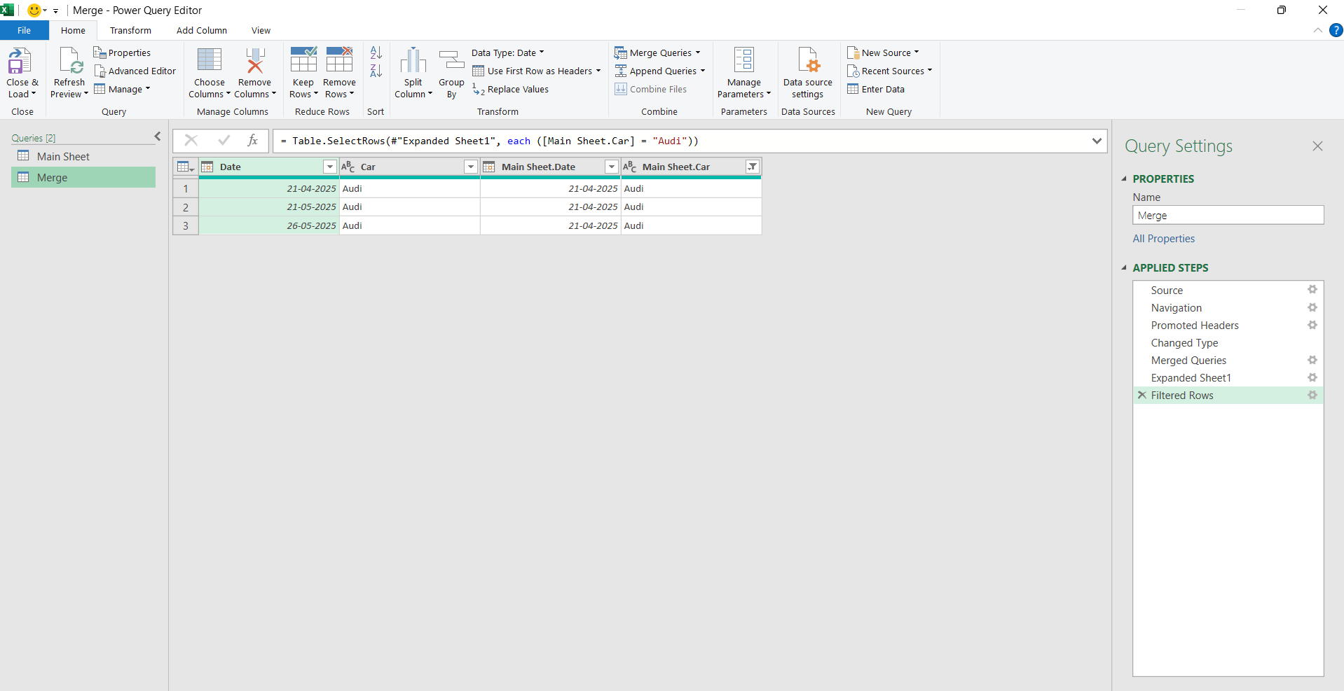

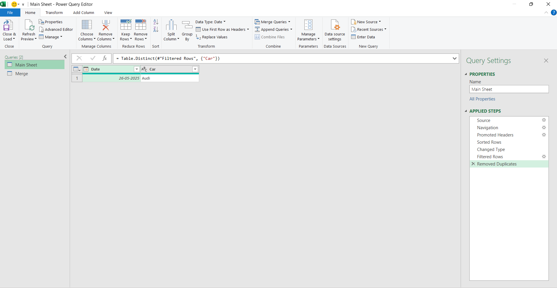

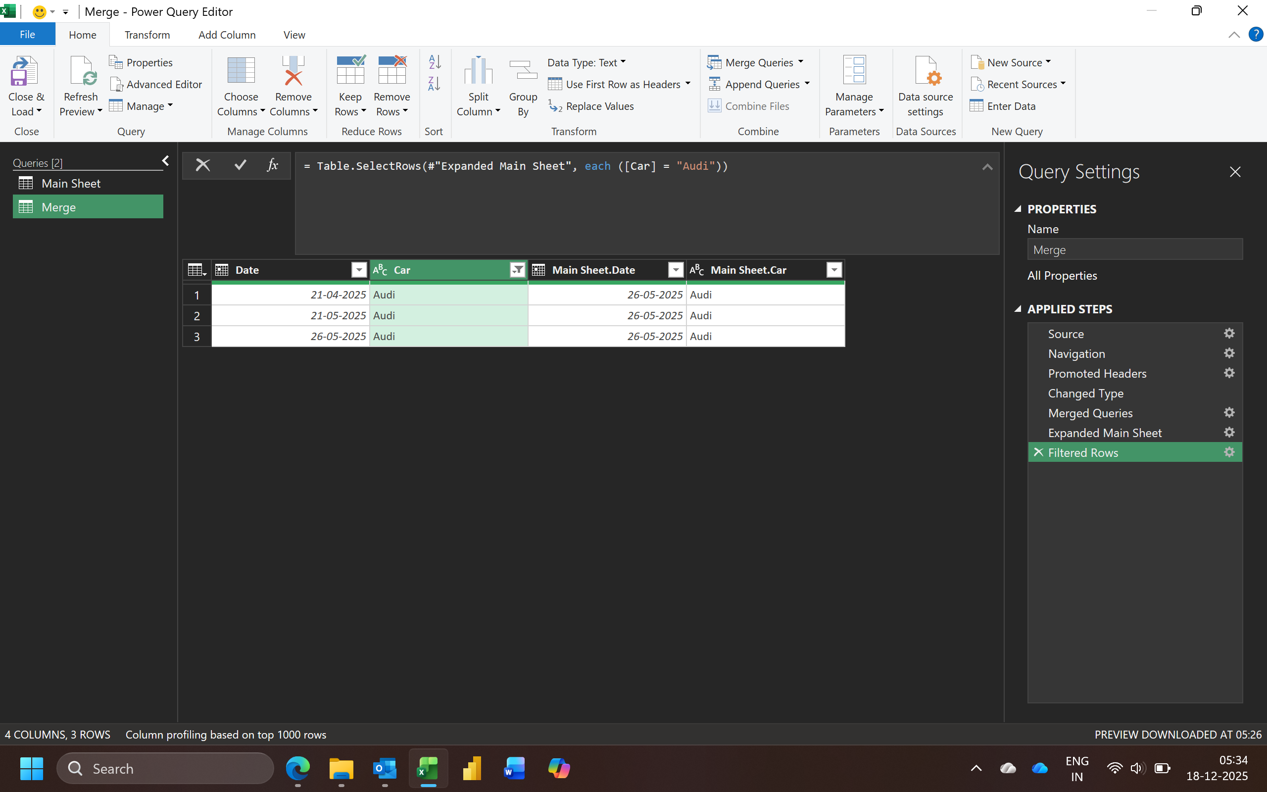

Check the screenshot where data is 26-05-2025 in main sheet and in merge sheet the data is pulled using merger query but resultant date is 21-04-2025 why? I have asked it with chatgpt also and it says its the way it is designed. What I understand is that after merge query it re-evaluates all steps and disregard the sorting order and then apply remove duplicate and pulls the result. in the main sheet i have applied sorting in descending order step. I have been using power query for more than a year and never doubted it, but this time it hits me. Imagine I need to calculate interest based on date pulled from another sheet and it pulls earlier date and I end up paying more on interest as it would calculate from 21-04-2025 and not from 25-05-2025. This is a serious issue that has questioned my faith in power query. I have always been confident regarding excel calculation and working until now.Merge
Main Sheet

    In the Main sheet, add this last step
    Table.Buffer(#"Removed Duplicates")

    I get how concerning this feel, and I want to help you lock this down reliably.
    The issue comes from how Power Query handles row order and duplicates: when you use Remove Duplicates after a sort, the engine can re-evaluate and reorder during a Merge, so Table.Distinct may keep the first row in a new order, pulling the earlier date instead of the latest.
    To make this deterministic, group by the key (e.g., Car) and return List.Max([Date]) as “LatestDate,” then merge to that aggregated query; or, if you prefer Sort + Distinct, add Table.Buffer right after the sort and before Table.Distinct to lock the order.
    As a quick check, add a Group step to your Main Sheet, confirm the LatestDate per car, and re-run the merge.
    If you still need the entire latest record, use Table.Group with Table.Max(_, "Date") instead of just the date.
    Can you share the M code for your Main and Merge queries and confirm whether your source is folding (e.g., coming from Excel vs. a database)?
    Also, do you need only the date or the full latest row for interest calculations?
