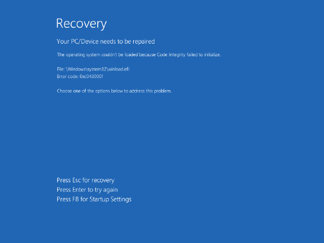

No changes were made on VM whatsoever, and today its not starting.
Agent status: Not Ready
Status: Stopped
gives error
  1. File: \Windows\System32\winload.efi
  2. Error code: 0xc0430001

    For this issue Azure virtual machine failed to start without any recent configuration or infrastructure changes.
    • Boot Error:
      • File: \Windows\System32\winload.efi
      • Error Code: 0xc0430001
    The VM was not able to complete the boot process.
    Root Cause:
    The issue was caused by a Windows Update–related boot corruption, impacting the Windows boot loader (winload.efi). Recovery attempts were blocked due to BitLocker encryption on the OS disk.
    Troubleshooting Steps Performed:
    1. Created a snapshot of the affected VM.
    2. Extracted the VHD from the snapshot and attempted to create a new VM using the same disk.
      • Result: The newly created VM also failed to boot.
    3. Attempted to use the Repair VM option by attaching the OS disk to a recovery VM for troubleshooting.
      • Limitation: The OS disk was BitLocker encrypted, which prevented us from proceeding with further repair and troubleshooting steps.
    4. As no successful repair was possible and the disk could not be accessed due to encryption, Dov proceeded with a restore operation.
    Resolution:
    • The VM was restored successfully from the August backup, which was the latest available healthy recovery point.
