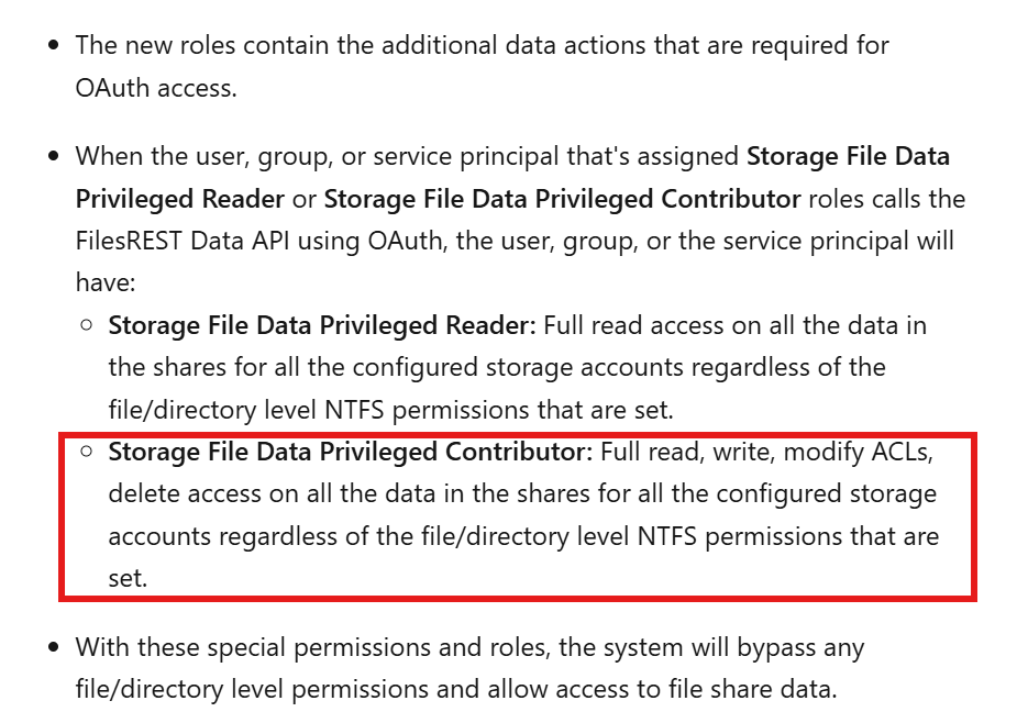

    You mentioned in the above question that your user has Blob and Files‑SMB roles, but not the Azure Files REST data‑plane role required for Entra ID/OAuth operations. Please assign Storage File Data Privileged Contributor (at the storage account or file share scope) to the identity used in Storage Explorer, then retry.
    Reference Document:
    https://learn.microsoft.com/en-us/azure/storage/files/authorize-oauth-rest?tabs=portal#privileged-access-and-access-permissions-for-data-operations
