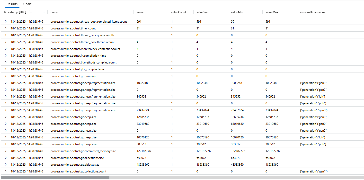

I have an Azure Function using Java 17 running on the Flex Consumption plan.
After turning on Open Telemetry using documentation found here:
https://learn.microsoft.com/en-us/azure/azure-functions/opentelemetry-howto?tabs=app-insights%2Cihostapplicationbuilder%2Cmaven&pivots=programming-language-java
I get unwanted system/process metrics related to dotnet which were not present before:
Following has been tried:
  • Setting environment variable OTEL_DOTNET_AUTO_METRICS_ENABLED to false does not turn them off
  • Setting environment variable OTEL_METRICS_EXPORTER to None turned off only my apps OTEL metrics but kept outputting unwanted system ones.
  • Setting log level to Warning on Host.Aggregator and OpenTelemetry
Host.json:

Any way to suppress these logs or turn them off?
