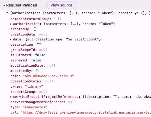

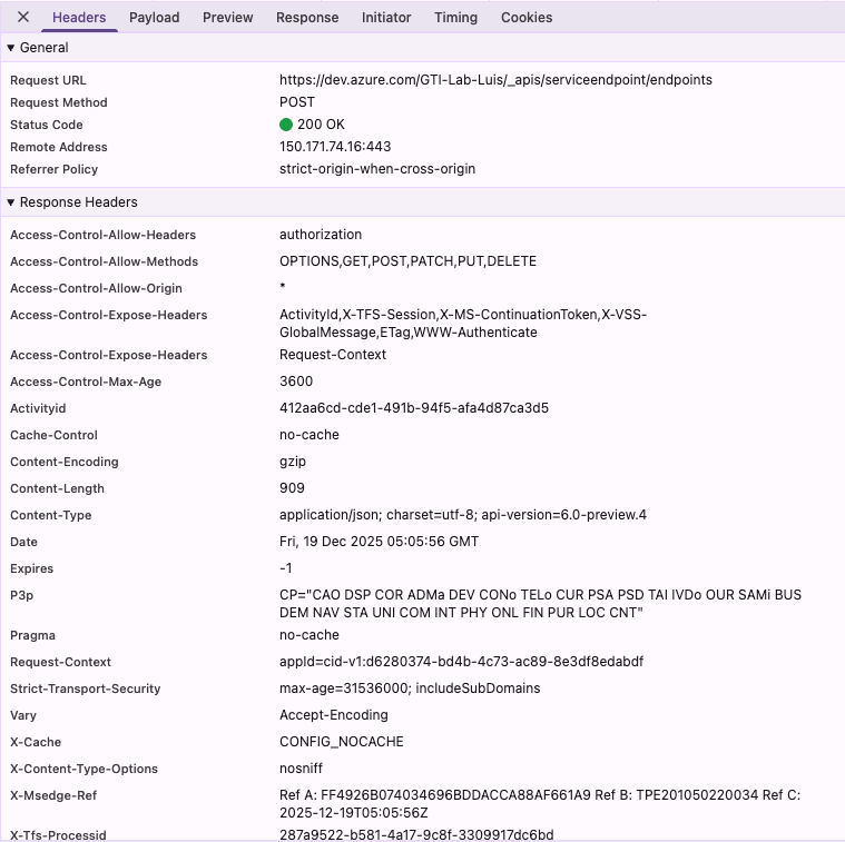

1. Capture UI Request
Using browser developer tools, capture the exact HTTP request the Azure DevOps UI sends when creating a Kubernetes service connection:
POST /GTI-Lab-Luis/_apis/serviceendpoint/endpoints?api-version=6.0-preview.4
Host: dev.azure.com
Authorization: Bearer <token>
Content-Type: application/json
Accept: application/json;api-version=6.0-preview.4
  "authorization": {
    "parameters": {
      "serviceAccountCertificate": "LS0tLS1CRUdJTi...",  // BASE64
      "isCreatedFromSecretYaml": "true",
      "apitoken": "ZXlKaGJHY2lPaUpTVXpJ..."  // BASE64
    "scheme": "Token"
  "data": {
    "authorizationType": "ServiceAccount"
  "name": "aks-test-connection",
  "type": "kubernetes",
  "url": "https://your-cluster.azmk8s.io:443",
  "description": "Test AKS connection",
  "serviceEndpointProjectReferences": [
      "projectReference": {
        "id": "your-project-id",
        "name": "Your-Project"
UI Result: ✅ Connection created, ✅ Works with kubectl task

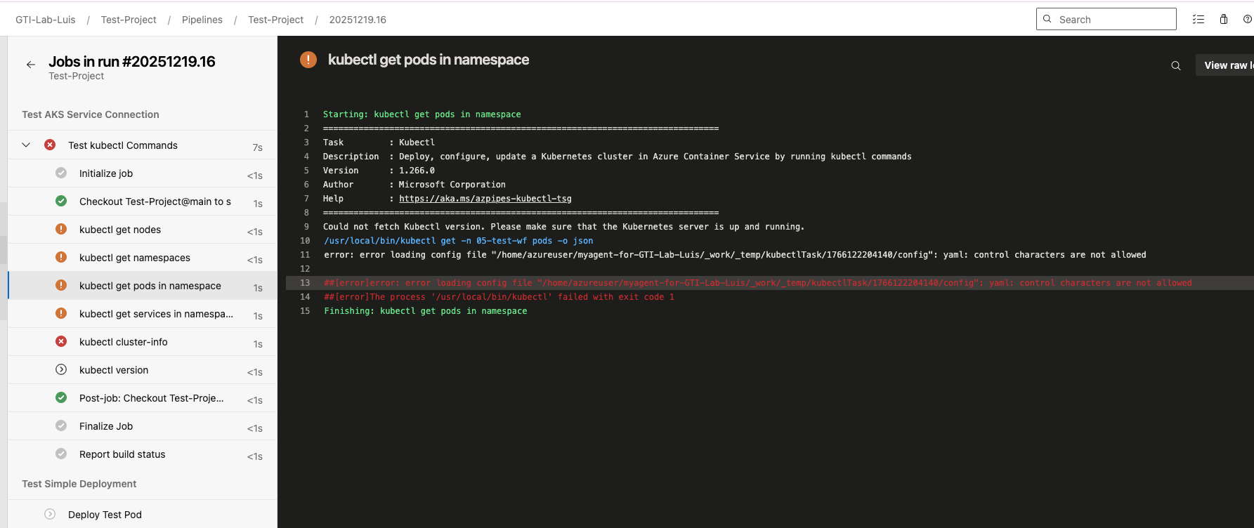

Error Messages Observed
When using the API-created connection with kubectl task:
Error 1 (Project-level endpoint, v7.1, decoded credentials)
error: error loading config file "/home/azureuser/.../config": yaml: control characters are not allowed
Error 2 (Project-level endpoint, v7.1, base64 credentials)
error: error loading config file "/home/azureuser/.../config": x509: malformed extension OID
Error 3 (Project-level endpoint, v7.1, mixed formats)
error: error loading config file "/home/azureuser/.../config": illegal base64 data at input byte 0
Error 4 (Organization-level endpoint, v6.0, base64 credentials) - Closest to UI
error: error loading config file "/home/azureuser/.../config": illegal base64 data at input byte 142

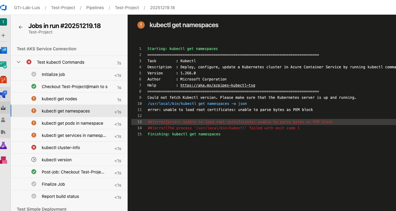

This time , the error is
Could not fetch Kubectl version. Please make sure that the Kubernetes server is up and running.
/usr/local/bin/kubectl get namespaces -o json
error: unable to load root certificates: unable to parse bytes as PEM block

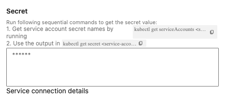

    One more thing is that it is impossible to view the secret after i created the service connection, may i know if there are any method to view it so that i can know the mistake the api made?
