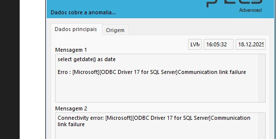

Scenario:
  • HP DL 380 G11
  • Server Windows Server 2025 Std DC
  • SQL 2022 Std
  • Workstations integrated into the domain with Windows 11 Pro. ODBC Version 18.
On the workstations, runs an application that works with a database existing in the single SQL instance.
  • Hibernation is disabled.
  • Any entry in the hardware manager that presents the power management option is also disabled.
Question: If the user is absent for any reason, the application registers a loss of communication with the server.
There is no loss of internet connection, and there is no loss of access to the server's shares.
Example: Before leaving, the user left two windows open of this application. When he returns, ( I'm still assessing the downtime), click on any of the windows and the aplication informe that lost the communication with the server.
Anyone can help me?
Thanks in advanced

    With no knowledge about your environment or this application, I can only speculate.
    • The most likely reason is that there is a network glitch at some point. Maybe in conjunction with DNS renewal or similar.
    • But it could also be that the application itself closes the connection after some time of inactivity and then is not able to recover.
    Possibly, you could use Profiler to track logouts for this user, to see if you can get some more clues. You would start Profiler when the user leaves his desk.
