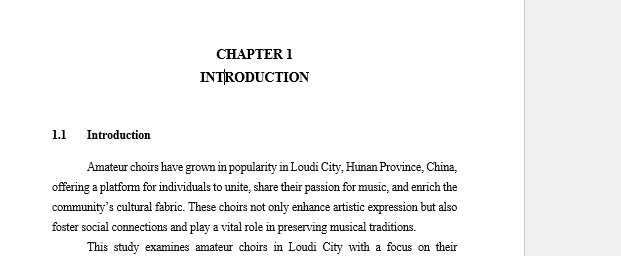

Some documents have a prblem regarding spacing.
I give example. the spacing is 1.5 (before 0pt, after 0pt). But there are diffrenet in gap between the space. Seem like a bigger shadow appear below and after word, image etc.

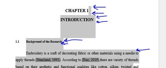

  2. Nur Aisyah Azmi 0 Reputation points
    2025-12-20T18:28:29.78+00:00
    Hi, i gve you example also, below is the common spacing 1.5,.. can see the different? The gap between line is smaller

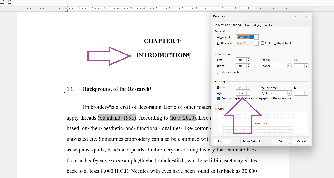

    Looking at your sample document, there is some additional paragraph spacing added to (some of) the text paragraphs, specifically Spacing After.
    The insertion point is in the main heading (Heading 1) and the Paragraph dialog box indicates Spacing After. See the screen shot below.
    Note that the paragraph spacing is specified in the "line" unit. I have forgotten what that unit actually means, but my guess is that it is relevant in some languages (maybe, but not necessarily, some East Asian languages).
    You can change the Spacing After back to whatever you prefer. Note that you have to type the value in points. Just using the arrow will keep the "line" unit of measurement.
    When you are done, update the style definition to match the selection.
