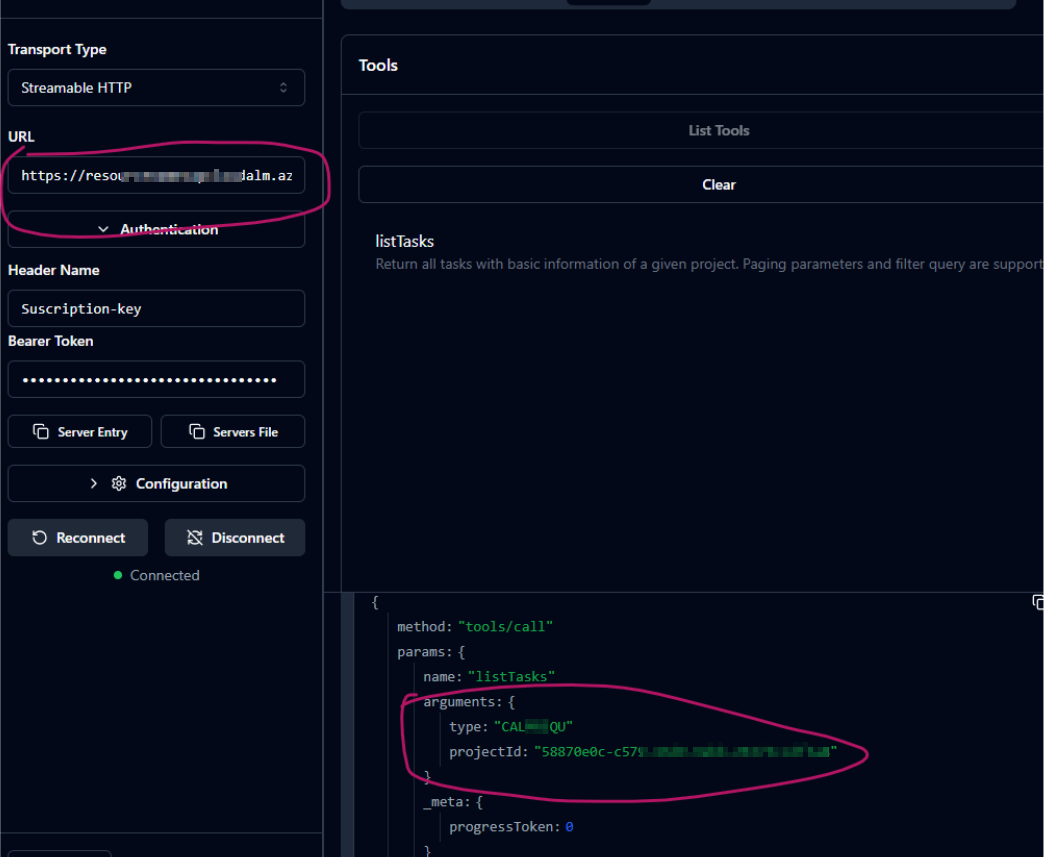

I have followed blog to expose SAP REST API's as MCP servers that need to be accessed via copilot studio / Microsoft new foundry : https://learn.microsoft.com/en-us/azure/api-management/export-rest-mcp-server. As of now the MCP server is exposing one tool listTasks which has several filter parameters . There is one mandatory argument projectId. When we pass only project ID , we get results:
But when we send other arguments like type , we get error : ' :
"text": "{"message":"Parameter value '58870e0c-c579-43d9-9ebb-26373ccdf3a8?type=CALMREQU' is not applicable."}"
Looks like the MCP server is wrongly passing the parameters to the SAP API . How should this be handled?

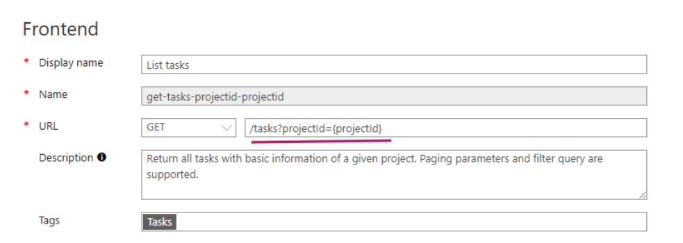

The problem is happening because "projectId" is defined as a URL template parameter in the original Open API, as shown below:
Due to this, the projectId incorrectly gets considered a "Url Segment" rather than a query string parameter which causes the issue. We will get this issue fixed in a future update (tentative ETA: 6 months).

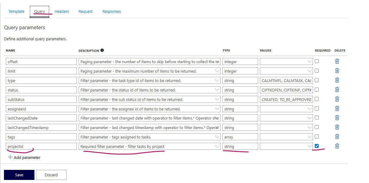

  1. Add a new query string parameter to the "List tasks" operation. The parameter name should be "projectId" and it should be marked as "required". Example below: User's image
    1. Remove "?projectId={projectId}" from the Operation URL, as shown below
    1. Save the changes After customer makes these changes, query string parameters should correctly get passed to the backend service.

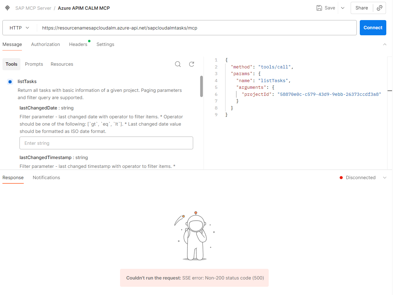

The product team has confirmed the workaround works perfectly fine and here's the response from the backend team:
The problem that customer ran into is different and has got nothing to do with the workaround implementation. Customer's machine has some connectivity or other problems due to which it cannot even connect to the MCP endpoint https://resourcenamesapcloudalm.azure-api.net/sapcloudalmtasks/mcp

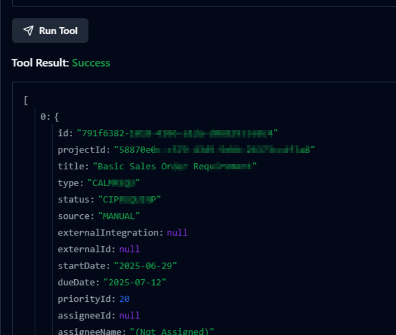

I just tested customer's service using MCP Proxy tool and the workaround is working perfectly fine. Parameters are now being passed correctly. See screenshot below: Request:
RESPONSE:
Please verify/investigate why your machine can't connect to the MCP endpoint. Kindly test it on a different machine and check if any connectivity issue is blocking your request.
