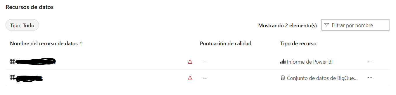

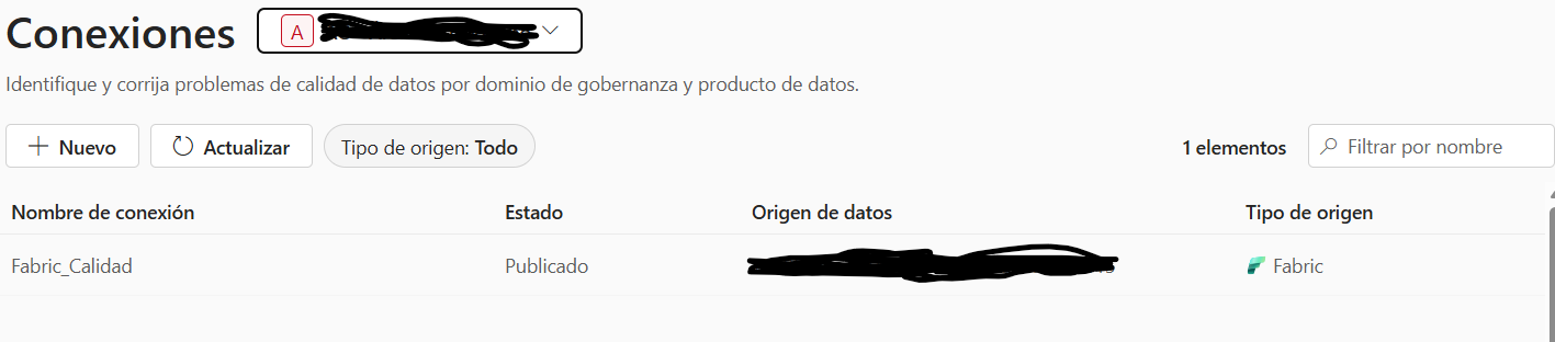

I have already created and published a connection in Purview (Fabric type), which appears correctly under the Connections section and shows a Published status. However, when I try to use this connection from the Data Resources view (for example, for a Power BI report or a BigQuery dataset), I receive the following error message:
“No se puede usar ninguna conexión. Cree primero una conexión para este recurso.”
English translation of the error:
“No connection can be used. Please create a connection for this resource first.”
This error is shown even though the connection already exists and is published.

·The connection is visible and active under Connections.

The message “No se puede usar ninguna conexión. Cree primero una conexión para este recurso” appears even though your connection is already Published. This is expected with the current version of Microsoft Purview Data Quality.
Purview can catalog and display Fabric, Power BI, and external sources like BigQuery, but these source types are not yet supported for running Data Quality rules. Because of that, the Data Quality panel cannot attach or reuse the existing connection, even if it appears under Connections > Published.
So the error is not caused by permissions or configuration. It is a product limitation:
  • Fabric / Power BI / BigQuery assets can be scanned and shown in the Data Map.
  • But they cannot be associated with Data Quality connections.
  • Purview therefore shows “no connection can be used” even when one is already created.
There are currently no additional steps, settings, or permissions that will make this type of connection usable for Data Quality.
