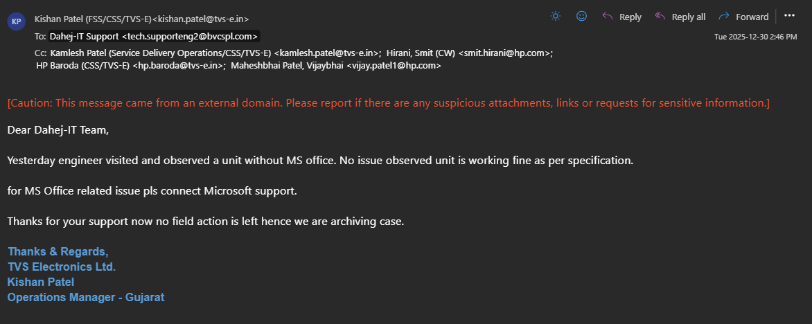

Laptop is functioning too slow. Even restarts Updates But Sam Issue And HP Teams Not Supported His Tell Me Contact Microsoft Teams Issued Form Microsoft Office
