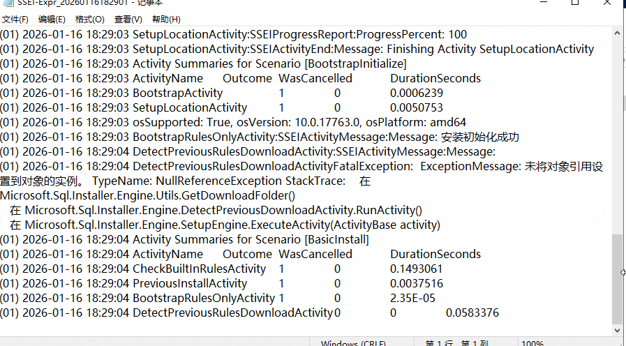

I'm writing a PowerShell script to execute the installer to install a sqlserver2019. I use the following command to run it.
C:\SQL2019-SSEI-Expr.exe /Q /IACCEPTSQLSERVERLICENSETERMS /CONFIGURATIONFILE=C:\Configuration.ini
config in Configuration.ini is
[OPTIONS]
ACTION="install"
SECURITYMODE=SQL
SAPWD="MYPASSWORD**"
FEATURES=SQLEngine
INSTANCENAME=SQLEXPRES
But i got this error
The main process of the SQL installation package failed to execute. Exit code:-1 + CategoryInfo : NotSpecified: (:) [Write-Error], WriteErrorException + FullyQualifiedErrorId : Microsoft.PowerShell.Commands.WriteErrorException,test.ps1
i find logs here
C:\Program Files\Microsoft SQL Server\150\SSEI\LogFiles\
i got this error detail
and I have already checked, and no other installer is currently running.
What are the next steps I should take to resolve this problem? Thanks

As far as I can tell, what is failing here is not your configuration options but the bootstrapper you are using. SQL2019-SSEI-Expr.exe is the SSEI web bootstrap installer (the small downloader). My understanding is that it's not supported for fully unattended / quiet installs with a configuration file. When run with /Q it still tries to execute interactive bootstrap activities such as DetectPreviousRulesDownloadActivity, which is exactly where your log shows a NullReferenceException. That exception is a known behavior of SSEI when forced into silent mode.
This is why you see:
Exit code: -1
and in the log:
DetectPreviousRulesDownloadActivity fatalException
Microsoft.Sql.Installer.Engine.Utils.GetDownloadFolder()
The fix would be to switch to the full media installer, which is the only supported method for unattended SQL Server installs.
