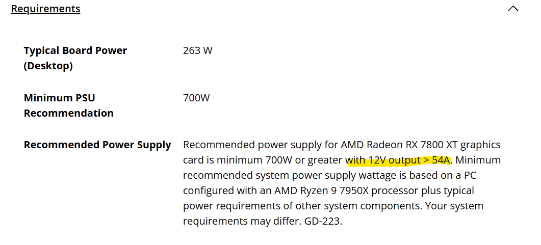

    Quote: "750 watt PSU"
    AMD recommends using a power supply with a power of at least 700 watts, but with a warning - the current along the 12 V power line should be more than 54 A:
    750 watts is the total power and how it is distributed over 3.3/5/12V is something to watch.
