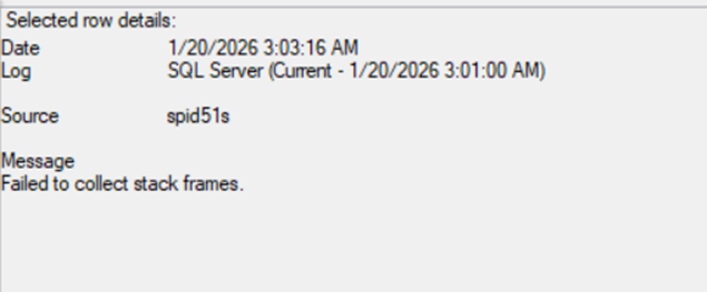

continuous sql error logs in secondary read replica always on node, failed to collect frames

  2. Erland Sommarskog 134.7K Reputation points MVP Volunteer Moderator
    2026-01-21T21:32:39.3233333+00:00
    I got update from an internal contact. It is a known issue that will be fixed in a future CU. While annoying, the message is harmless. If you don't want to wait for the CU, I can only recommend you to open a support case.

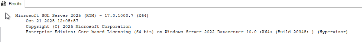

  3. Erland Sommarskog 134.7K Reputation points MVP Volunteer Moderator
    2026-01-20T21:16:52.47+00:00
    I see that you are running SQL 2025. Query Store on readable secondaries was introduced in SQL 2022, but only as a preview feature. With SQL 2025, it is no longer preview, so noise like that should not occur.
    I would suggest that you open a support case, so that Microsoft can investigate. Most likely they will need call stacks and other diagnostics, which they will ask you to collect.
