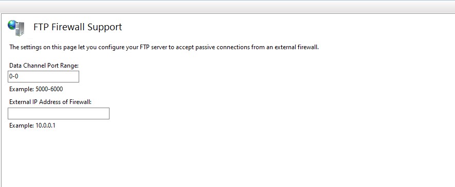

After doing the math for P1 and P2 that I learned ((P1*256)+P2), the port is correct as the range is 5000-5100.
