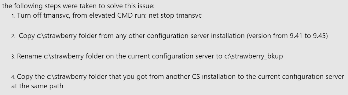

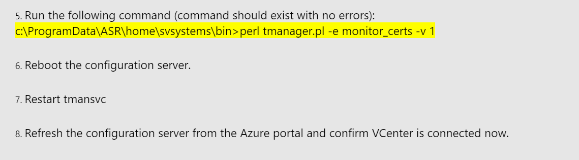

  1. SadiqhAhmed-MSFT 49,331 Reputation points Microsoft Employee Moderator
    2021-10-19T07:03:19.507+00:00
    @lufas - Sharing the solution with broader community.
    If the response helped, do "Accept Answer" and up-vote it
