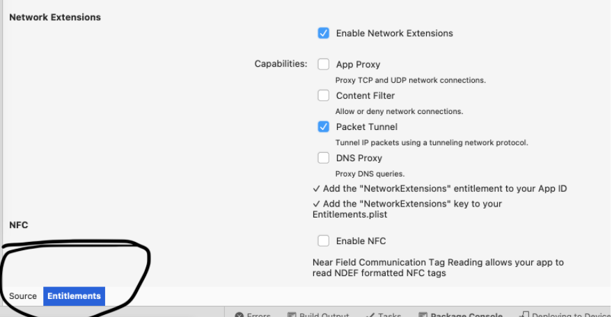

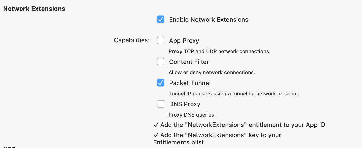

One thing would like to share Visual Studio for Mac 2019 adds incorrect entitlement when graphical editor is used. It adds value for key com.apple.developer.networking.networkextension as packet-tunnel instead of packet-tunnel-provider.

    1. I still do not agree the value for key com.apple.developer.networking.networkextension is packet-tunnel. You cannot deploy to a real device with that value. Even you download provisional certificate from Apple developer website with which you are signing and open it in text editor though it is a binary file, it clearly states the value as packet-tunnel-provider, how come then packet-tunnel works is a mystery to me. I lost 2 weeks for it.
    When you work with Network Extensions, packet-tunnel will be added, my VS for Mac version is 8.10.10 . For more information, you can refer to
    https://learn.microsoft.com/en-us/xamarin/ios/deploy-test/provisioning/capabilities/?tabs=macos
