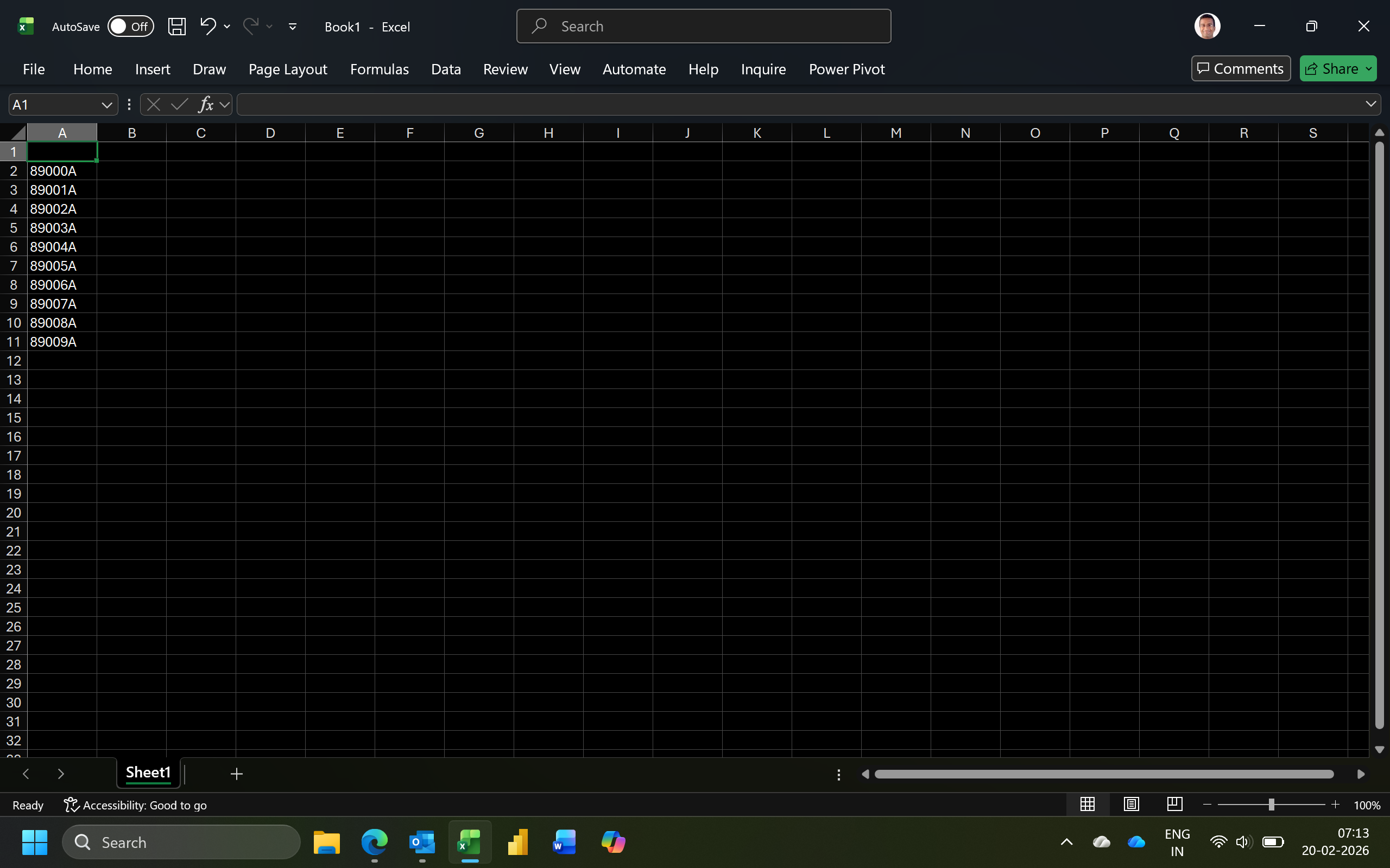

  1. Ashish Mathur 101.9K Reputation points Volunteer Moderator
    2026-02-20T01:43:31.14+00:00
    Enter this formula
    =SEQUENCE(10,1,89000)&"A"
    Hope this helps.
