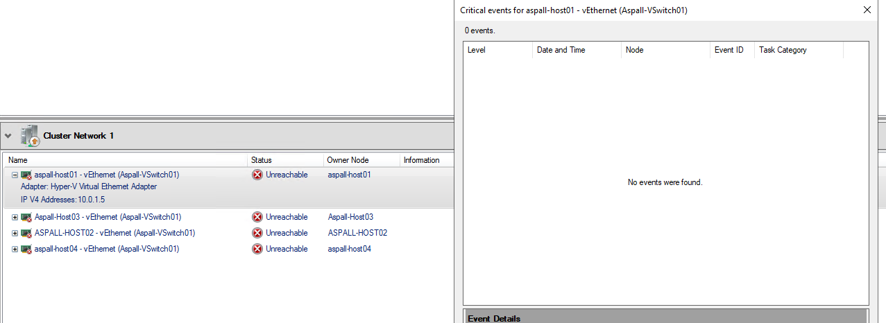

We have a 4 node 2019 failover cluster running Hyper-V VMs.
We have started seeing that one of our networks is showing as "Partitioned" as below:
The nodes can ping each other on that network, port 3343 is open, and there are no firewalls in between the nodes.
The cluster is currently operating correctly as far as I can see, but I'd like to resolve this error to prevent any possible issues.
Can anyone advise how to correct this?

  1. Aspall IT 436 Reputation points
    2021-10-20T11:06:19.54+00:00
    After I disabled and re-enabled cluster and client traffic on this network, even though I made no changes to host or switch side network config, the network status restored to normal.
    I'll be keeping an eye on it to ensure stable, but this does seem to have resolved the issue, and doesn't seem to have been config related.
    Many thanks
    James

  2. Eric Siron 1,586 Reputation points MVP
    2021-10-11T18:00:59.633+00:00
    In Failover Cluster Manager:
    1. Start on the Networks node
    2. Highlight the troubled network ("Cluster Network 1" in this case)
    3. At the very bottom of the FCM window, look for the Summary and Network Connections tabs. Switch to Network Connections
    4. In the pane that contains those tabs, in the space above the tab that you just clicked, look for clues
    This space shows the hosts and adapters that have presence in this network by assigned IP address and netmask. Unfortunately, ping is not terribly useful in this case.
    I have only seen it happen once, and that appeared to be because my physical switch and the Hyper-V virtual switch could no longer agree on VLAN frames. I only did cursory troubleshooting and did not discover anything. I believe the problem lies with the physical switch, as I have dozens of similar configurations and only the one displayed the problem. Removing the virtual adapters from their VLANs and relying on layer 3 isolation worked for me.
