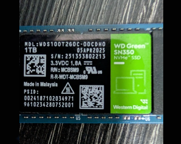

I'm having trouble installing a clean version of Windows 11 on my HP Victus 15-fb1013dx. During the installation process, specifically at the "Where do you want to install Windows?" screen, the SSD is not being detected ("No drives were found").
Here are my hardware specs:
Model: HP Victus 15-fb1013dx (Product: 598U1AV / UPC: 197961792355)
CPU: AMD Ryzen 5 7535HS
GPU: NVIDIA GeForce RTX 2050
  • Storage: NVMe SSD 1TB
I suspect the issue is related to the storage controller driver for the AMD 7000 series chipset that needs to be loaded during the setup. Could someone please point me to the specific driver (.inf) I need to put on my bootable USB to make the drive visible?
Thanks in advance for your help!

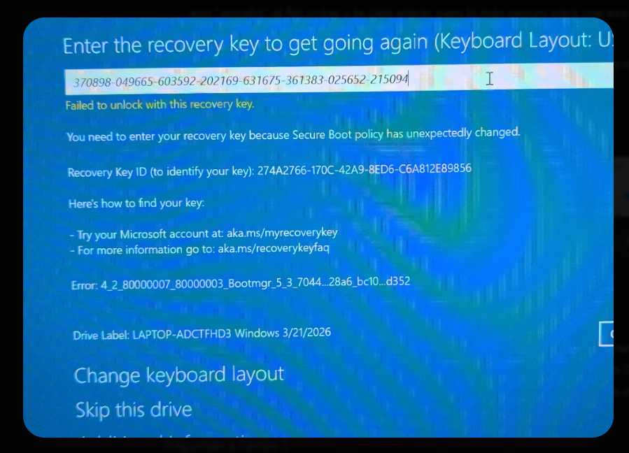

  1. HP Victus AMD Ryzen 5 32gb 0 Reputation points
    2026-03-23T04:06:16.8466667+00:00
    After this process, the disk never worked again.
