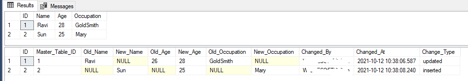

  1. MelissaMa-MSFT 24,221 Reputation points
    2021-10-12T02:41:34.933+00:00
    Hi @Ramadas Ravikumar ,
    Welcome to Microsoft Q&A!
    Please refer to below and check whether it is helpful to you.
    --DDL
    create table Tool_Management
    (ID int identity(1,1),
    Name varchar(100),
    Age int,
    Occupation varchar(100))
    insert into Tool_Management(Name,Age,Occupation) values
    ('Ravi',26,'GoldSmith')
    create table Tool_Management_History
    Master_Table_ID int,
    Old_Name varchar(100),
    New_Name varchar(100),
    Old_Age int,
    New_Age int,
    Old_Occupation varchar(100),
    New_Occupation varchar(100),
    Changed_By varchar(100),
    Changed_At datetime,
    Change_Type varchar(20))
    --create update trigger
    create trigger my_trigger_update_Tool_Management_History
    on Tool_Management
    after update
    as
    begin
      insert into Tool_Management_History(Master_Table_ID,Old_Name ,New_Name ,Old_Age,New_Age,Old_Occupation,New_Occupation ,Changed_By,Changed_At,Change_Type)
      select a.id,b.Name,case when a.Name=b.Name then NULL else a.Name end,b.Age,case when a.Age=b.Age then NULl else a.Age end
      ,b.Occupation,case when a.Occupation=b.Occupation then NULL else a.Occupation end,SYSTEM_USER , GETDATE(),'updated'
      from inserted a
      inner join deleted b
      on a.id=b.id
    end
    --create insert trigger
    create trigger my_trigger_insert_Tool_Management_History
    on Tool_Management
    after insert
    as
    begin
      select id,NULL,Name,NULL,Age,NULL,Occupation,SYSTEM_USER , GETDATE(),'inserted'
      from inserted
    end
    --perform some insert and update actions
    update  Tool_Management
    set Age=28
    where id=1
    ('Sun',25,'Mary')
    --validate the results
    select * from Tool_Management
    select * from Tool_Management_History
    Output:
    Best regards,
    Melissa
