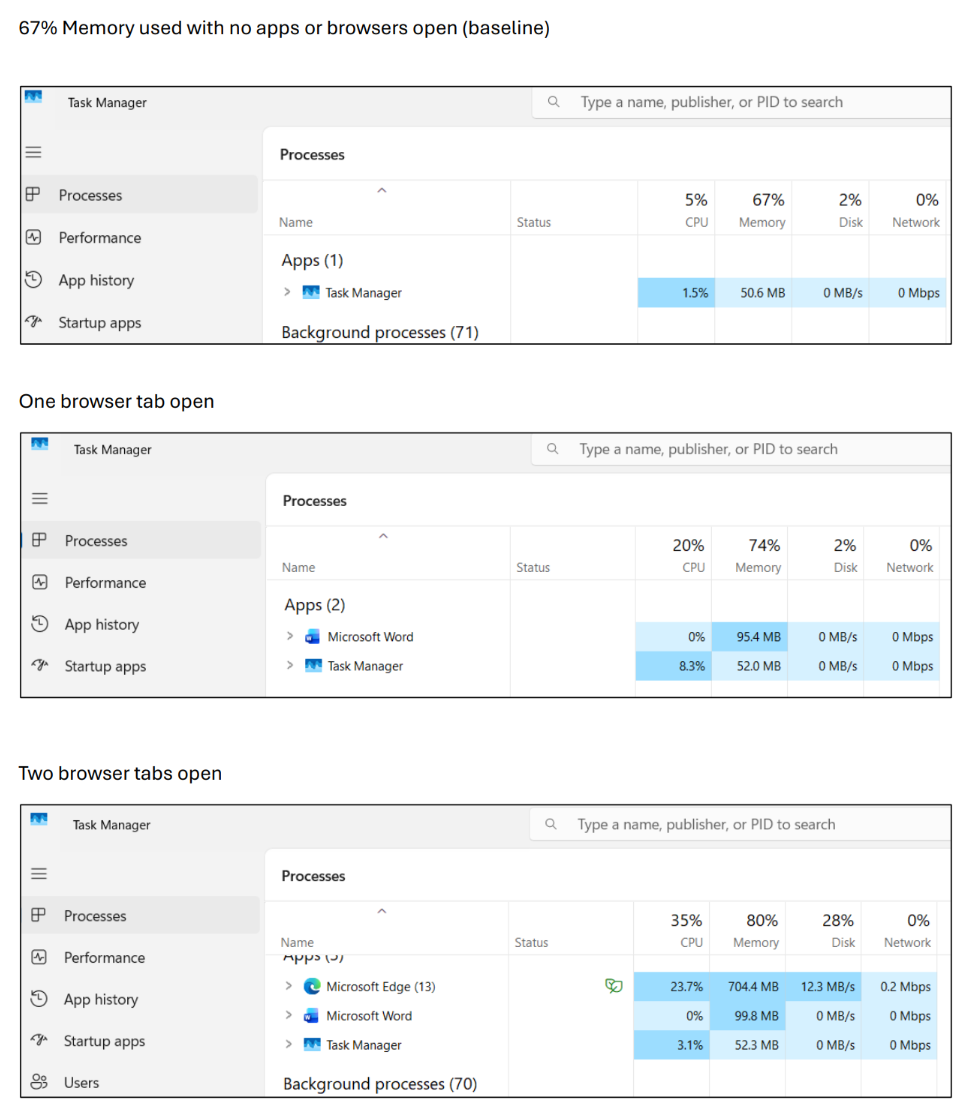

Hello,
We’re currently using several Windows 365 Cloud PCs to access our Microsoft 365 GCC High tenant. The machines are configured with Windows 365 Enterprise (2 vCPU / 8 GB RAM / 256 GB storage, GCCH subscription per user).
We’ve been experiencing noticeable latency during routine tasks. For example, when saving a Word document, it takes approximately 17 seconds just to browse to the destination folder and another 17 seconds to complete the save, about 34 second lag time total.
The delay is even more pronounced when converting Word documents to PDF. It takes around 17 seconds to navigate to the folder, an additional 48 seconds to save the PDF, and roughly 1 minute and 6 seconds total before the file appears on screen.
These delays are significantly impacting usability, even for basic day-to-day operations.

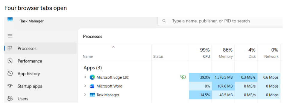

While monitoring Task Manager and watching the cursor spin for 45 seconds, I do not see the CPU or Memory max out when saving documents, but the memory is almost maxed out with no apps or browsers open, and the CPU does max out at times.
 Is the latency an issue across all Cloud PCs regardless of the specs?
We want to provision five additional Cloud PCs If we can solve the latency issue. We are looking the lowest-cost option: Windows 365 Enterprise (2 vCPU / 4 GB RAM / 64 GB storage, GCCH subscription per user) but we question if the low-end spec cloud PC even usable or is it just going to freeze up?

    First of all, please check your background processes, as they also consume memory, not just active applications. The issue may be caused by tasks running in the background.
    When the CPU hits 99% during simple folder navigation, it seems struggling with real-time security scanning or background tasks that are significantly more resource-intensive in a GCCH environment. And for a stable professional experience, you should upgrade these users to a 4 vCPU / 16 GB RAM tier to provide the necessary ceiling for Microsoft 365 apps to function without constant resource contention.

    The behavior described isn’t expected for all Cloud PCs and isn’t inherent to Windows 365. Latency and “freezing” are typically caused by a combination of:
    • Where the Cloud PC is provisioned vs. where users and application data reside
    • Network routing and protocol usage
    • Undersized Cloud PC resources for the workload
    From the screenshots, CPU and memory are already heavily utilized on a 2 vCPU / 8 GB Cloud PC with only light usage. Moving to a lower spec (2 vCPU / 4 GB / 64 GB) would further constrain resources and is likely to worsen responsiveness, not improve it.

    4. Right-size Cloud PC resources
      • The current 2 vCPU / 8 GB configuration is already close to its limits based on Task Manager screenshots. For typical office workloads with multiple browser tabs and Office apps, 4 GB RAM is generally insufficient and will increase paging and CPU contention.
      • If the existing 2 vCPU / 8 GB Cloud PCs are struggling, the 2 vCPU / 4 GB / 64 GB option is likely to be less usable, especially when running Microsoft Edge plus Office apps and converting documents to PDF.
      • If performance issues persist after addressing region and network, consider resizing existing Cloud PCs to a larger SKU (more vCPU/RAM) rather than downsizing. Windows 365 Enterprise supports remote resizing of vCPU, RAM, and storage.
