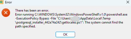

While installing Postgresql i am geting "There has been an error. Error running C:\WINDOWS\System32\Windows PowerShell\v1.0\powershell.exe -Execution Policy Bypass -File "C:\Users\\AppData\Local\Temp \postgresql_installer_442a74a242\getlocales.ps1""
Jagadeesh Kumar 20 Reputation points
2026-04-10T00:17:24.38+00:00
I am getting the above mentioned error while installing PostgreSQL in my laptop Can anyone help me in this regard

Hi Jagadeesh Kumar,
I understand how frustrating it is when your PostgreSQL installer fails with a PowerShell error before it even finishes. From the error message in your screenshot, this is likely a PostgreSQL installer issue more than Windows itself. Here’s what you can try:
1 - Re‑run the installer from a simple path
  • Check whether your Temp folder is accessible:
    • Press Win + R > type %TEMP% > press Enter
    • If that fails, it means the installer cannot find its script
  • Run the PostgreSQL installer again but from more simple location:
    • Redownload it (e.g. to C:\Downloads\PostgresSQL folder)
    • Right‑click the installer > Run as administrator.
2 - Temporarily allow the installer’s PowerShell script
  • Press Win + X > Open Windows PowerShell / Terminal as Administrator
  • Run: Set-ExecutionPolicy -Scope Process -ExecutionPolicy Bypass
  • Keep that window open > run the PostgreSQL installer again.
3 - If the installer keeps failing
  • Download the ZIP version of PostgreSQL
  • Extract it to a simple folder like C:\Downloads\PostgreSQL
  • PostgreSQL can work normally this way, just without the setup wizard.
If the issue persists, let me know if there’s any new error appear when you attempt to open the Temp folder or trying the PowerShell script.

  1. nobuko c 123.7K Reputation points Independent Advisor
    2026-04-10T12:39:10.8133333+00:00
    Hello,
    This issue occurs because PowerShell script execution is restricted during the PostgreSQL installation. As a workaround, please temporarily enable script execution in Group Policy.
    Press the Windows key + R at the same time, type gpedit.msc, and click OK.
    • Local Group Policy:
    Computer Configuration > Administrative Templates >Windows Components > Windows PowerShell > “Turn on Script Execution”
    Set this policy to:
    “Allow local scripts and remote signed scripts”
    After changing the setting, run the PostgreSQL installer again.
    Once the installation is complete, please revert the policy to its original state.
