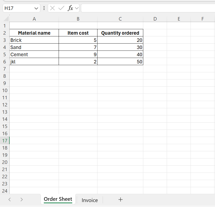

hi, I have created an order sheet on excel, listing materials, with item cost and qty column.
on another tab I created an invoice. is it possible when I enter qty of material on the order sheet it can automatically update the invoice with material name, qty and cost on each line?

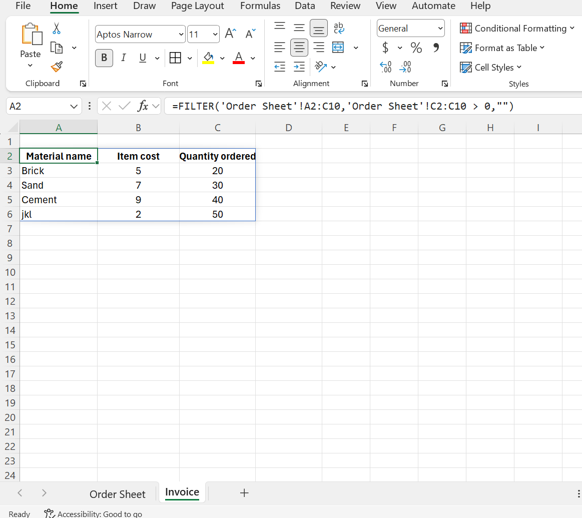

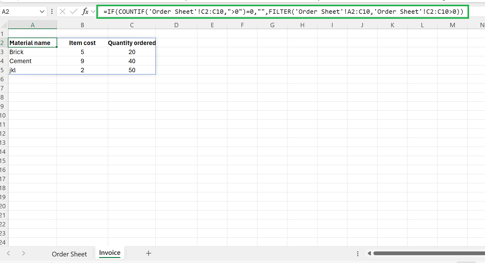

    Based on the structure you described, you can use Excel’s FILTER function to automatically display only the items that have a quantity entered on your order sheet.
    In your "Order Sheet", you can start from row 2, where cell A2 contains the header “Material name”, column B contains the "Item cost, and column C contains the "Quantity".
    Your "Invoice" sheet can start empty. On the "Invoice" sheet, in cell A2, enter the following formula:
    =FILTER('Order Sheet'!A2:C10,'Order Sheet'!C2:C10>0,"")
    This formula works as follows:
    • The range 'Order Sheet'!A2:C10 is the source data that you want to display on the invoice.

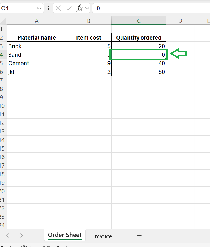

    • The condition 'Order Sheet'!C2:C10 > 0 tells Excel to include only rows where the quantity is greater than zero.
    • The empty quotes at the end define what is shown if no items have a quantity entered.
    Once this is in place, go back to the "Order Sheet" and enter quantities for any materials you want to include. When you switch to the "Invoice" sheet, you will see only those materials automatically listed, along with their cost and quantity.
    This approach is intentionally simple, so whether it fully fits your needs depends on how complex you want the invoice to be later. However, it is a good starting point and often feels easier to manage if you prefer to avoid more advanced formulas or automation.
    Please feel free to try it and let me know if this works comfortably for your scenario.
