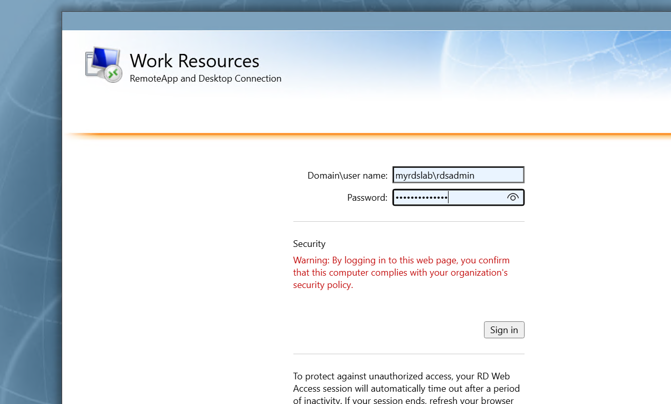

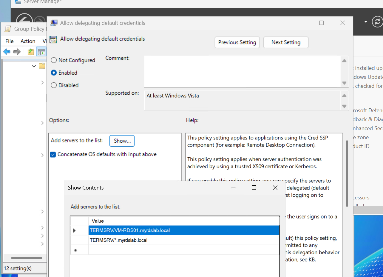

Anybody here managed to make SSO on RDS works ? Device guard credential disabled, following GPO (wk19/22 method) applied :
But user prompted for credential when using RD GATEWAY...:(

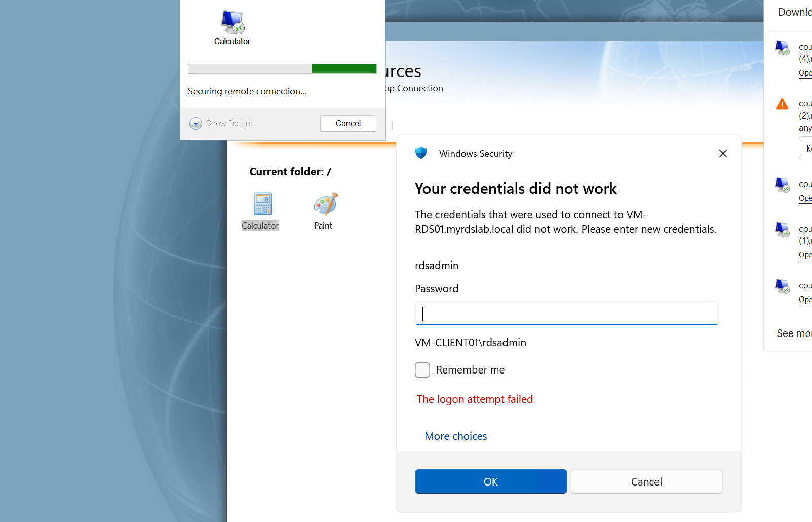

The Windows Security prompt in your second screenshot reveals the reason your Single Sign-On is failing. The authentication dialogue shows the domain as your local client machine name rather than your actual Active Directory environment. This indicates your system is attempting to pass a local machine account token instead of a valid domain credential to the remote server. For Remote Desktop Single Sign-On to function properly via Kerberos, the Local Security Authority on your client must obtain a Ticket Granting Ticket from your domain controller during your initial Windows login. You need to ensure you are logged into your physical client desktop using your domain credentials so the system can seamlessly delegate that specific token to your RDS environment.
Your Group Policy configuration for delegating default credentials under the Computer Configuration, Administrative Templates, System, and Credentials Delegation path is perfectly configured for your target servers. Furthermore, you were correct to disable Remote Credential Guard, as this feature explicitly blocks the type of credential delegation required when brokering connections through an RD Gateway. Since your policies are already in place, simply joining this client to the domain if it is not already and authenticating your initial desktop session against your Active Directory will allow the Kerberos handoff to succeed without prompting you for a password when launching RemoteApps on Windows Server 2025.

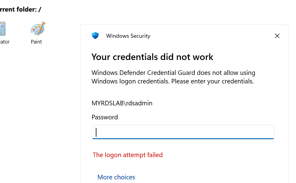

    your third image isolates the root cause of the ongoing issue. Despite your earlier configuration attempts to disable it, the prompt explicitly states that Windows Defender Credential Guard is still actively running on your client machine. Starting with recent Windows 11 builds, this feature is enabled by default and utilizes virtualization-based security to intentionally block the CredSSP delegation required for your Single Sign-On to function, regardless of your other Group Policy settings.
    To resolve this and allow your domain credentials to pass through the RD Gateway, you must ensure Credential Guard is completely disabled at the system level on the client machine connecting to the RDS environment. You can enforce this by navigating to the local Group Policy Editor under Computer Configuration, Administrative Templates, System, and Device Guard. Locate the Turn on Virtualization Based Security policy and ensure the Credential Guard Configuration drop-down is set to Disabled. Alternatively, you can open the Registry Editor and navigate to HKEY_LOCAL_MACHINE\SYSTEM\CurrentControlSet\Control\Lsa, creating or modifying the DWORD value named LsaCfgFlags and setting its value data to 0. Because Credential Guard initializes before the operating system kernel loads, you must perform a full reboot of the client machine for these changes to take effect and for the SSO token delegation to succeed.
