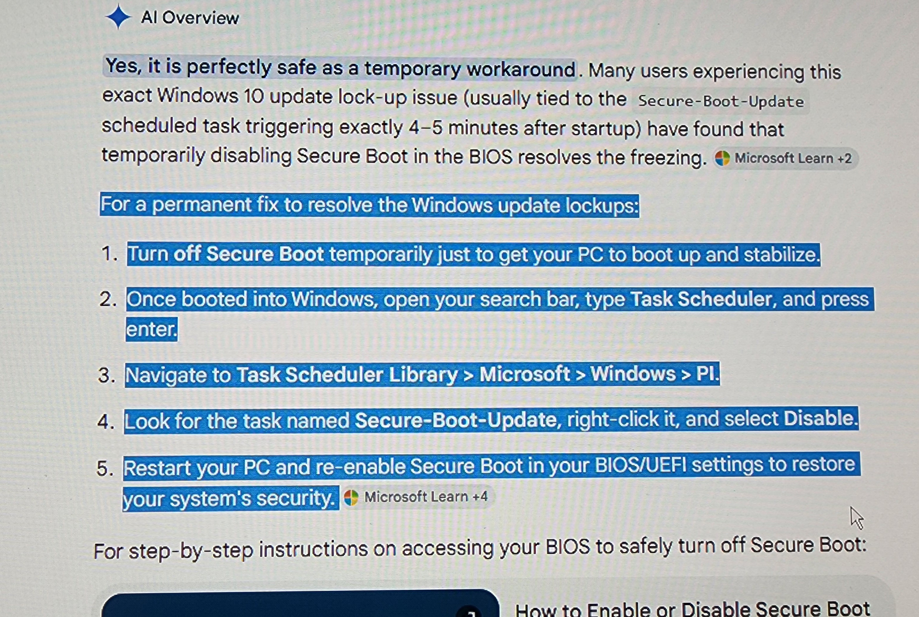

I had the same Windows 10 Windows locking up issue with the June 9th 2026 patch.
Based on your suggested fix, I did an internet search for details and found this attached instruction (see image I attached) that says after turning off Secure Boot in Safe Mode and logging into Windows, you should disable a certain item in Windows Task Scheduler. Then, log back out of Windows, reboot in Safe Mode, re-enable Secure Boot, save and re-log into Windows. I wouldn't have gotten there, however, without You providing the first steps which I did my search on.
I did these additional steps beyond what you suggested and my machine has been working now for 30 minutes without freezing up.1000031568
