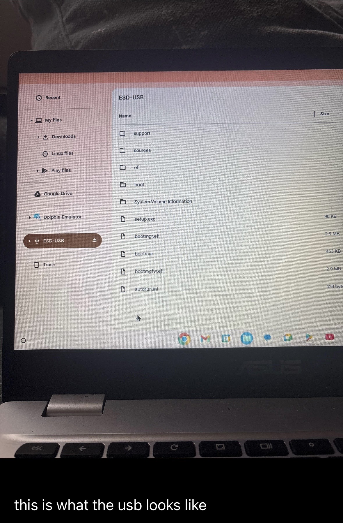

    If that does not get Windows booting up. what method did you use to create the bootable USB and please provide a screenshot of the contents of the bootable USB you have created.
