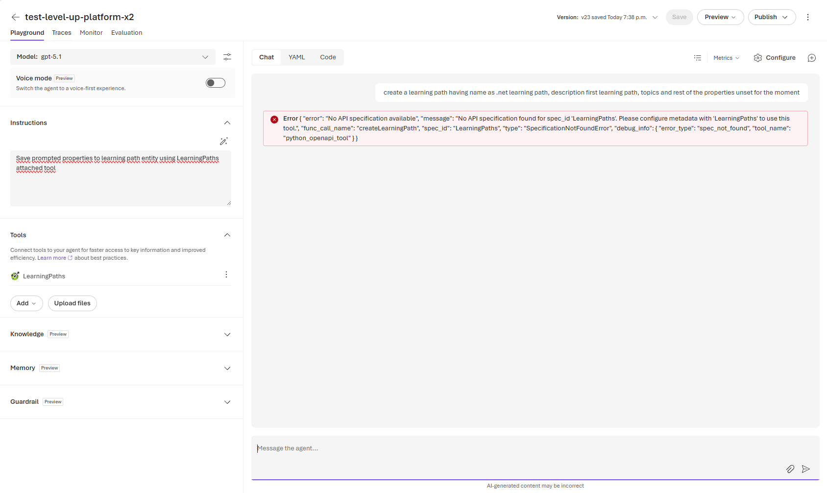

Hello,
I'm trying to create a Microsoft Foundry Agent that can access my API deployed on Azure Web App, but I'm encountering the following error:
Captură de ecran 2026-05-18 193822
Below is my current OpenAPI configuration:

    Welcome to Microsoft Q&A .Thank you for reaching out to us.
    Based on the behavior observed, the API endpoint itself appears to be functioning correctly, since direct API testing succeeds outside the Foundry Agent environment.
    The key indicator is the following runtime error
    SpecificationNotFoundError
    No API specification found for spec_id 'LearningPaths'
    This error occurs before the API call is executed and typically indicates that the Foundry Agent runtime is unable to locate a successfully registered OpenAPI specification for the attached tool. Based on the current behavior, the issue appears more closely related to OpenAPI tool registration, specification ingestion, or runtime binding rather than the Azure Web App API implementation itself.

    Thank you for posting on MS Learn Q&A.
    The agent tried to call:
    spec_id: "LearningPaths"
    tool_name: "python_openapi_tool"
    but Foundry could not find a saved OpenAPI spec registered under that spec definition.
    So the issue is most likely in the tool metadata not in your Azure Web App endpoint.

  3. AI answer
    2026-05-18T16:47:35.65+00:00
    The error message indicates that the agent doesn’t have an API specification bound to the OpenAPI tool with spec_id LearningPaths. The issue isn’t with the JSON itself, but with how the tool is configured and saved in Microsoft Foundry.
