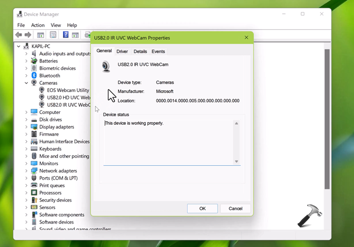

    Check with Device Manager, if you've IR based webcam installed there and is working fine.
    Fix: Facial recognition not working in Windows 11
