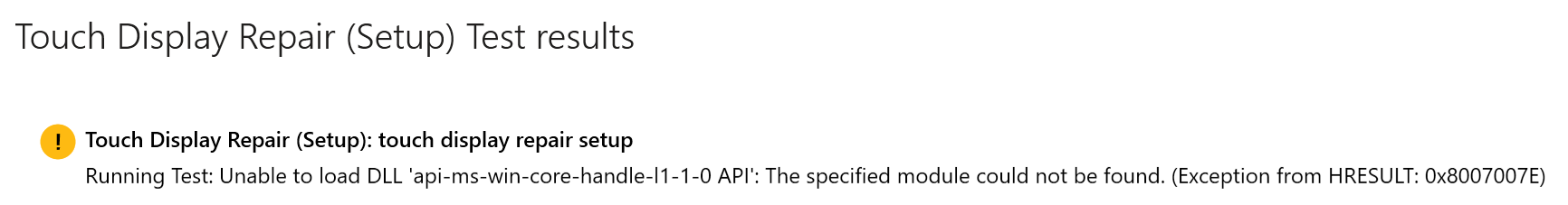

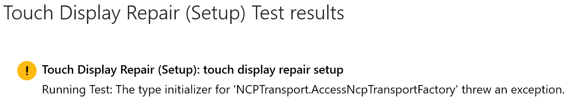

Hi, I have problem with run touch display setup on my Surface pro 8, win 11 25H2. Test ends with error NSPTransport. Touch panel is working and display have flicking ani I need replace it. But I need first step Touch display setup to set surface for remove display. User's image

  1. Lukáš Hrňa 0 Reputation points
    2026-06-04T18:19:32.8766667+00:00
    On my windows 11 still not working, I reinstall to windows 10 from https://www.microsoft.com/en-us/software-download/windows10 Maybe if I reinstall windows 11 then working too.
    Surface diagnostics toolkit from storage still not working
    Local STD now working:
    1. Create local user admin
    2. Extract zip file with surface diagnostics toolkit from https://www.microsoft.com/en-us/download/details.aspx?id=100440 to users\[localUser]\SDT
    3. run power shell as admin and go to folder
    4. run Unblock-File * or dir | Unblock-File
    5. run dir -Recurse | Unblock-File
    6. Start surface diagnostics toolkit
    And now working.
    Thank you very much @S.Sengupta for your help.
  2. Lukáš Hrňa 0 Reputation points
    2026-05-25T19:18:07.8833333+00:00
    I tried download another version SDT from https://www.microsoft.com/en-us/download/details.aspx?id=100440 But errorUser's image
  3. S.Sengupta 30,891 Reputation points MVP Volunteer Moderator
    2026-05-25T00:35:39.5166667+00:00
    That NCPTransport error is often related to missing .NET components.
    Install:
    Download .NET 8.0
    .NET Framework 4.8.1
    Download Surface Pro 8 Drivers and Firmware
