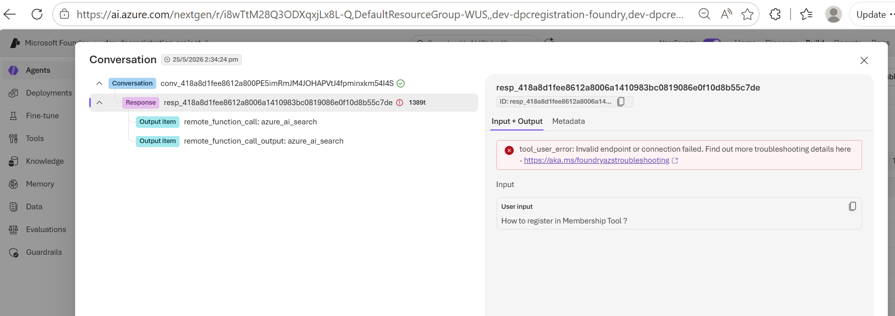

Hi ,
I am trying to access Azure AI search service but receiving the error as Invalid endpoint or Connection Failed in New Azure AI Foundry AI_Search_error1.png

    Thank you for sharing the details of the scenario. The error “Invalid endpoint or Connection Failed” in Azure AI Foundry agents typically indicates that the Azure AI Search tool connection is unable to successfully establish connectivity during execution.
    From the observed behavior, the issue occurs at the tool invocation layer, meaning the request does not proceed to query execution in Azure AI Search. This generally points to a misconfiguration or connectivity-related issue involving endpoint configuration, authentication, or network access. However, in certain cases, the behavior may also persist even after validation steps are completed, indicating a dependency on service-level interaction.

    I think the agent hits “Invalid endpoint or Connection failed” when the Search endpoint URL or the index name doesn’t match what actually exists in the Azure AI Search resource.
