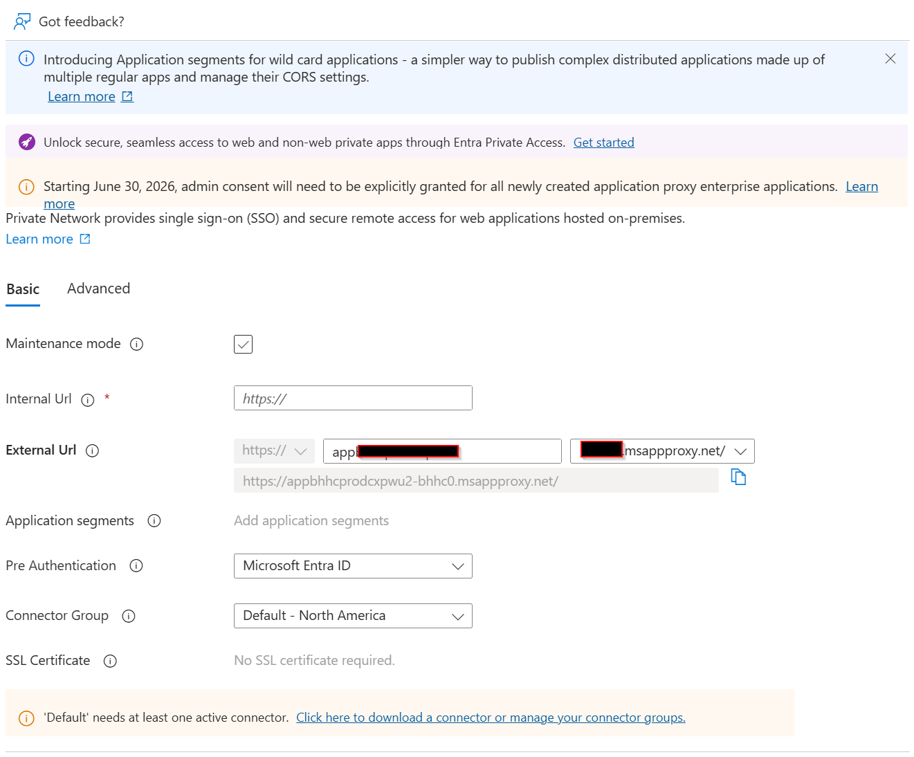

In Entra ID, I am trying to edit the application proxy settings of an Enterprise Application.
The initial configuration is with "Internal URL" is blank
The External URL is app.domain-msappproxy.net
See the attached for the initial configuration
When I add an "Internal URL" to https://appname.contoso.com/appweb/.
Then change the External URL to appname.contoso.com (a legitimate domain).
I also change the "Connector Group" to the correct App Proxy Connector Group. Click Save
The following message appears in the notification "Private Network settings update successfully"
However, then the screen refreshes back to the initial configuration (the screen shot). I cannot figure out when the changes I made are not taking. I have tried it both in portal.azure and entra.microsoft. with the same results. Any way to further troubleshoot this or any idea why the changes are not saving even though the notification says it has saved successfully? appproxy123
