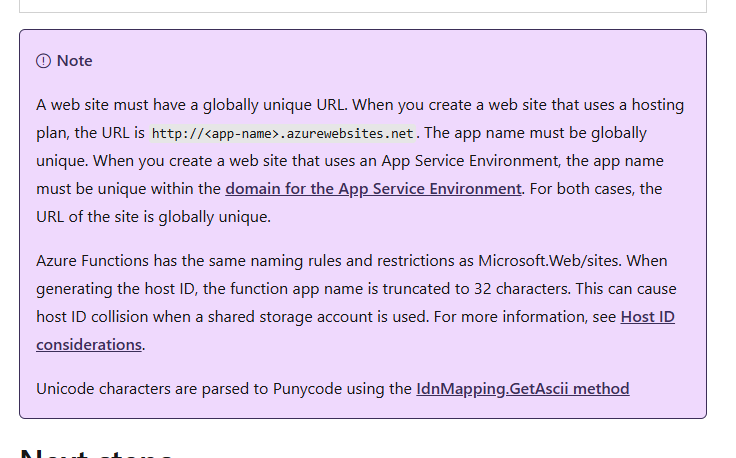

Since you deleted the App Service approximately six months ago, the 30-day soft-delete retention period has long passed, and the name should now be available for reuse. However, Azure holds onto names for a bit longer sometimes due to internal DNS propagation and subdomain takeover protection mechanisms. This can occasionally cause the “already exists” error to persist even after the retention window.

https://learn.microsoft.com/en-us/troubleshoot/azure/app-service/create-delete-resources-faq-new
https://learn.microsoft.com/en-us/azure/app-service/app-service-undelete?tabs=portal
https://learn.microsoft.com/en-us/azure/azure-resource-manager/management/resource-name-rules
