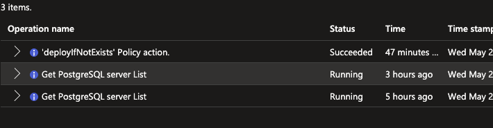

  1. Rafa Lachica Garrido 40 Reputation points
    2026-05-27T15:43:01.05+00:00
    It almost took 5h based on the image below:
