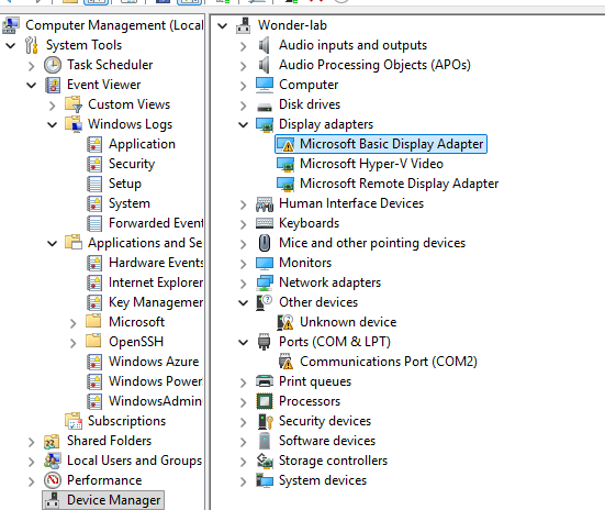

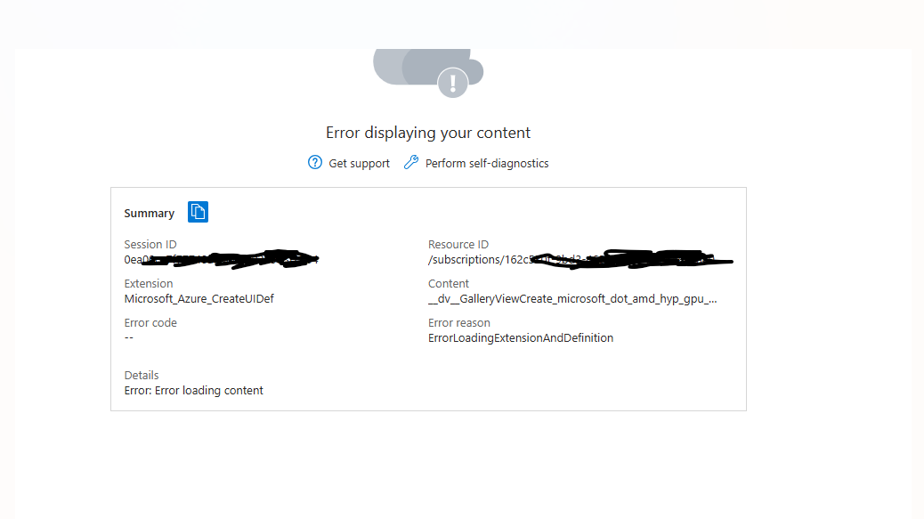

Hi Team
Getting the following error when installing the AMD GPU driver (No other driver is installed)
  • Error reason ErrorLoadingExtensionAndDefinition
  • Details Error: Error loading content
  • Extension Microsoft_Azure_CreateUIDef
Tate

Thank you for providing the detailed information and screenshots. I appreciate your patience while we reviewed the issue.
Based on the behavior observed, this issue does not appear to be related to the AMD GPU hardware or the VM provisioning itself. The error is occurring before the actual GPU driver installation starts.
The message ErrorLoadingExtensionAndDefinition associated with Microsoft_Azure_CreateUIDef generally indicates that the Azure Portal is unable to properly load the extension configuration UI required for deploying the AMD GPU driver extension. In these scenarios, the issue is typically related to the Azure Portal experience, extension metadata loading, browser cache/session issues, or compatibility validation with newer operating system builds.
As an initial step, please try clearing the browser cache and cookies, using an InPrivate/Incognito session, or switching to Microsoft Edge before retrying the operation. In many similar cases, this resolved the issue by forcing the Azure Portal to reload the extension UI components correctly.

    this looks like an Azure Portal extension blade/UI loading problem, not necessarily a driver install failure. Microsoft_Azure_CreateUIDef and Error loading content usually means the portal failed to load the extension definition form. Try installing the AMD GPU extension from CLI instead of Portal.
