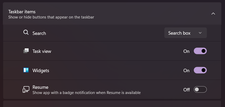

I installed the new update to Windows,
and when my laptop came back on, the Windows Action Centre and Time were gone from my taskbar.
I tried restarting my laptop, and then i went into the taskbar settings,
and neither the Windows Action Centre or the Time were under the menu to add to the taskbar.User's imageUser's image

  1. Gunasekar N 70,385 Reputation points Independent Advisor
    2026-05-28T05:59:02.22+00:00
    Hello, thank you for reaching out to Microsoft Q&A.
    1
    Restart the Windows Explorer process -
    Open the Task Manager and locate the Windows Explorer process.
    이미지
    Right-click on it and select Restart.
    This will refresh your taskbar.
    2
    Run the System File Checker Utility Scan.
    Open the Command Prompt (Administrator) Window.
    Run these commands one by one and click Enter for each command.
    Dism /Online /Cleanup-Image /RestoreHealth
    sfc /scannow
    Once completed, restart your computer.
    3
    Re-register Shell components.
    Open PowerShell as administrator.
    Run the command below and click Enter.
    Get-AppxPackage -AllUsers | Foreach {Add-AppxPackage -DisableDevelopmentMode -Register "$($_.InstallLocation)\AppxManifest.xml"}
    Let me know if you still need more help.
