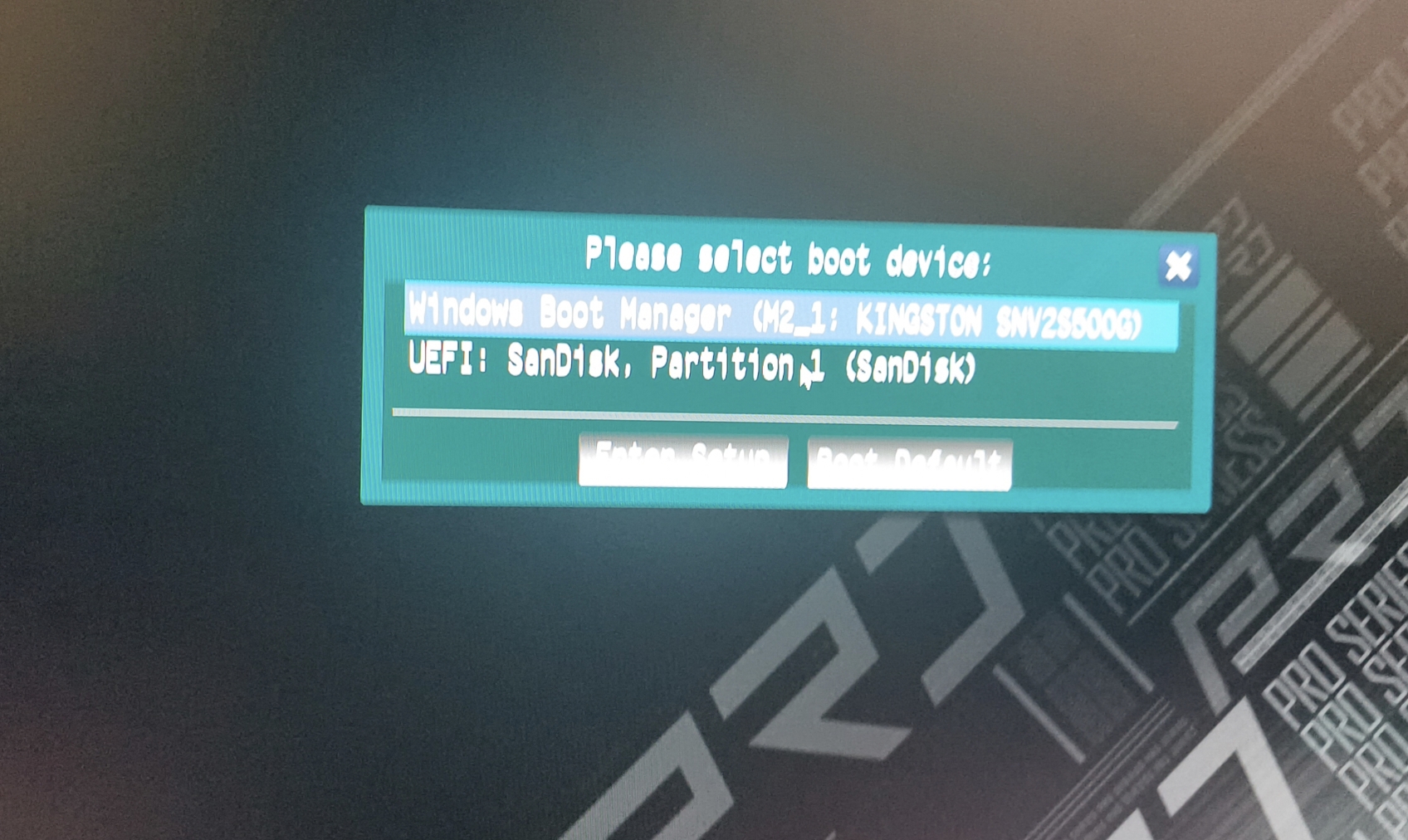

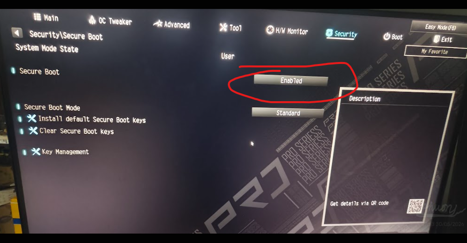

Hello,
I am currently experiencing an issue while trying to install Windows.
When I boot from the installation media and reach the step where I need to select a drive for installation, I can see all of my drives correctly. However, when I select a drive and proceed, the installer immediately returns to the previous screen, preventing me from continuing the installation process.
All storage devices are detected properly, but I am unable to complete the Windows installation.
Could you please help me identify the cause of this issue and suggest a solution?
