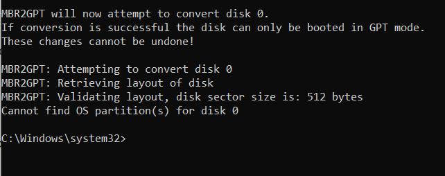

Having an issue when using the aforementioned tool.

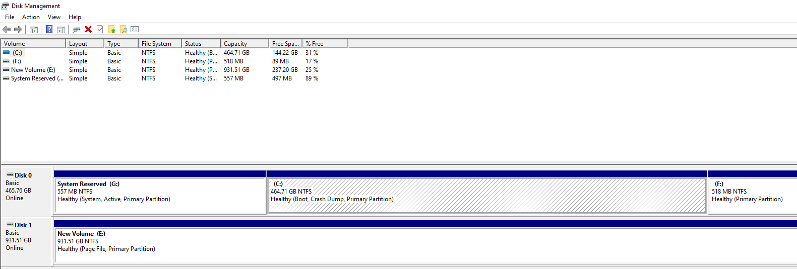

Disk Manager shows the following
I do have an intermittent issue with the PC failing to find an operating system after POST where I have to restart, go into the BIOS and then manually select volume D (Disk 0) above. This happened after upgrading from the original HDD to NVME which I assigned to being the C drive and believed I had migrated all the windows files to.

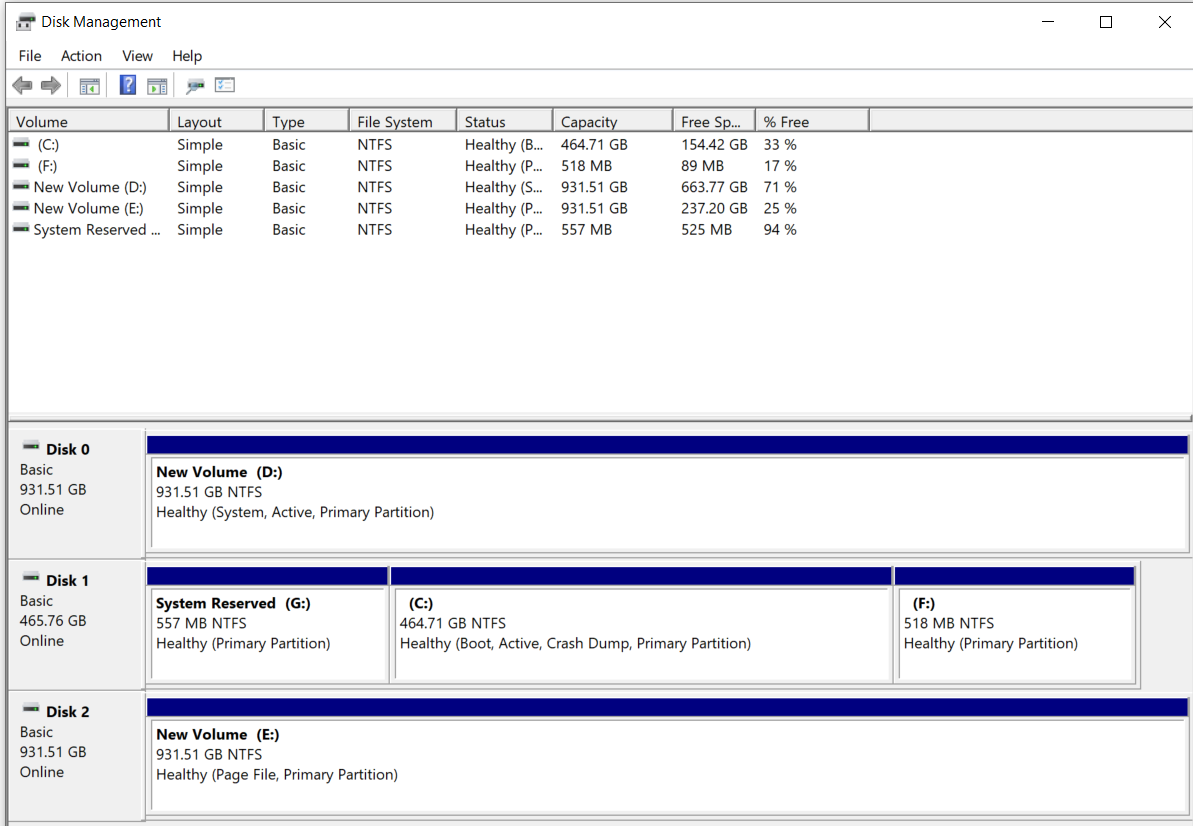

    It does not matter what changes you make to disk 1 as long as you are booting off disk 0.
    You should try a totally different approach including using MBR2GPT from outside Windows.
    Step 1: Move the "Active" flag from drive C to drive G. Mark drive G as active in disk management.
    Step 2: Add boot files to drive G. Run
    bcdboot C:\Windows /s G: /f ALL
    Now you need to get off booting from disk 0. Preferably remove the disk.

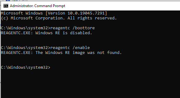

    Run
    reagentc /boottore
    and reboot to recovery environment. Inside recovery environment run command prompt and try to convert disk 1 without the AllowFullOS switch so System reserved gets converted to EFI.

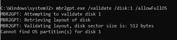

    The mbr2gpt command can only be run on the disk containing the Windows operating system, in your screenshot, that seems to be Disk 1, not Disk 0, have you tried to run that command on Disk 1?
