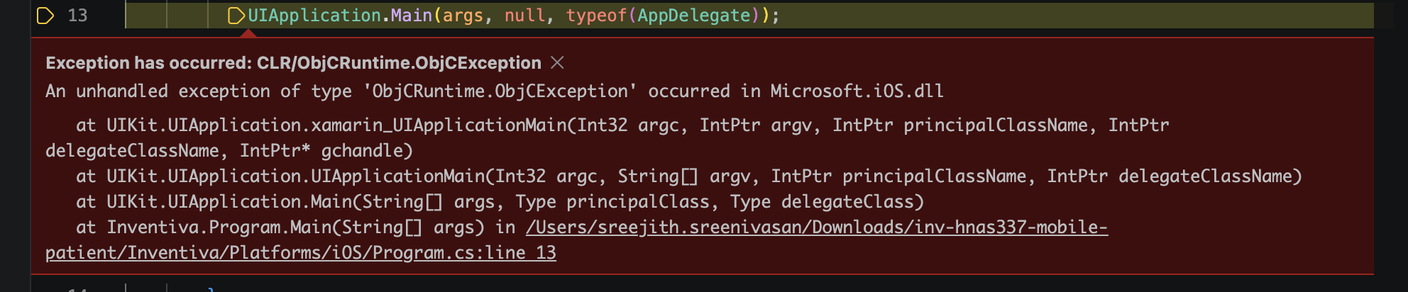

I am facing below exception when running the .net 10 maui project on visual studio code:
Screenshot 2026-06-01 at 12.38.54 PM
Exception has occurred: CLR/ObjCRuntime.ObjCException
An unhandled exception of type 'ObjCRuntime.ObjCException' occurred in Microsoft.iOS.dll
   at UIKit.UIApplication.xamarin_UIApplicationMain(Int32 argc, IntPtr argv, IntPtr principalClassName, IntPtr delegateClassName, IntPtr* gchandle)
   at UIKit.UIApplication.UIApplicationMain(Int32 argc, String[] argv, IntPtr principalClassName, IntPtr delegateClassName)
   at UIKit.UIApplication.Main(String[] args, Type principalClass, Type delegateClass)
   at Inventiva.Program.Main(String[] args) in /Users/sreejith.sreenivasan/Downloads/inv-hnas337-mobile-patient/Inventiva/Platforms/iOS/Program.cs:line 13
Initially the project is in .net 8 and now I upgraded it to .net 10, but same issue.
I can share the terminal logs and console logs on one to one. I am also working on a demo for this and once it is complete I will share that too?

    Since the issue only occurs on iOS and not Android, and given that you've already tried multiple approaches without success, I'd like to suggest creating a blank MAUI project and running on ios emulator to help us narrow down whether the root cause is coming from your project configuration/packages or from the iOS environment/SDK setup itself.
    Please let us know the result so we can proceed with the next steps accordingly.

    ObjCRuntime.ObjCException indicates that an Objective-C exception was thrown by native iOS code and bubbled up into managed code during UIApplication.Main. In .NET for iOS / .NET MAUI this typically happens when a native API is called with invalid arguments or when a platform API throws (for example, NSInvalidArgumentException).
    In .NET for iOS, Objective-C and managed exceptions use different runtimes. When a native Objective-C exception is thrown and the stack unwinder reaches managed frames, the Objective-C runtime cannot execute managed try/catch/finally blocks. Instead, the exception is surfaced as ObjCRuntime.ObjCException and the app terminates. This behavior is by design and is independent of whether the project targets .NET 8 or .NET 10.
    Key points from the platform behavior:
    • Native Objective-C exceptions (for example from UIKit or Foundation) are not reliably catchable with managed catch (Exception) blocks.
    • When such an exception occurs during UIApplicationMain, it appears as an unhandled ObjCRuntime.ObjCException in Microsoft.iOS.dll, with the call stack rooted at UIApplication.Main / Program.Main.
    • Only the MonoVM runtime supports unwinding native frames during managed exception handling; CoreCLR aborts the process when encountering this situation.
    To troubleshoot in the app:
    1. Identify which native call is failing. The actual cause is usually in the first native frames above UIApplicationMain (for example, a call into UIKit or a bound Objective-C API). Inspect the full stack trace and any logged NSException message (such as NSInvalidArgumentException).
    2. Fix the underlying misuse of the native API (for example, avoid passing null/IntPtr.Zero where not allowed, or avoid calling selectors that are not available on the current OS version).
    3. Avoid relying on managed try/catch around native calls to handle Objective-C exceptions; instead, prevent them by validating arguments and platform support before calling.
    As an illustration from the platform documentation, the following code throws an Objective-C NSInvalidArgumentException in native code and cannot be reliably caught by a managed try/catch:
    var dict = new NSMutableDictionary();
    dict.LowlevelSetObject(IntPtr.Zero, IntPtr.Zero); // throws NSInvalidArgumentException
    The Objective-C stack unwinder can unwind native frames, but it cannot correctly unwind managed frames or execute managed catch/finally blocks, so the process terminates with an ObjCRuntime.ObjCException.
    In summary, upgrading from .NET 8 to .NET 10 does not change this fundamental behavior. The resolution is to locate and correct the native API usage that is causing the Objective-C exception, rather than attempting to handle ObjCRuntime.ObjCException in managed code.
