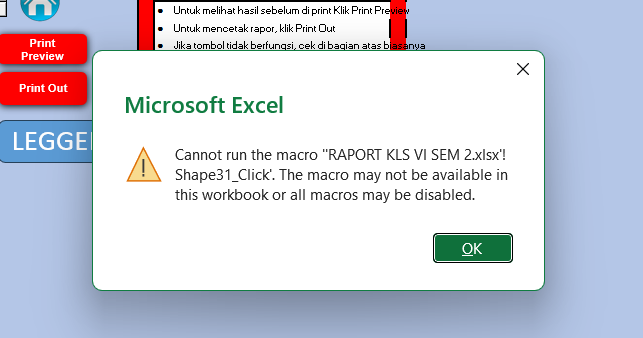

Isnaini Ni'mah 0 Reputation points
2026-06-02T06:57:56.5466667+00:00
How can i fix this? I try to assign macro but it didn't work. And thhe macro setting is already enabled
  1. Emmanuel Santana 39,635 Reputation points Independent Advisor
    2026-06-02T07:36:59.77+00:00
    Hello. One very important detail here is that your screenshot shows the workbook is saved as:
    RAPORT KLS VI SEM 2.xlsx
    A normal .xlsx file cannot properly store VBA macros. If the workbook originally contained macros and was later saved as .xlsx, Excel removes the VBA project but the buttons/shapes may still remain and continue trying to call the old macro, which produces this exact error.
    Please check this too:
    1. Save the workbook as a macro-enabled workbook:
    File → Save As → Excel Macro-Enabled Workbook (*.xlsm)
    Then close and reopen the file.
    1. Press:
    ALT + F11
    to open the VBA Editor.
    Check whether the procedure:
    Sub Shape31_Click()
    still actually exists. Also check inside:
    • Modules
    • Sheet objects
    • ThisWorkbook
    because button event procedures are sometimes stored in sheet modules rather than standard modules.
    1. In the VBA Editor, try:
    Debug → Compile VBAProject
    If there is a syntax error or broken reference anywhere in the project, Excel may prevent ALL macros from running even if the clicked macro itself is correct.
    1. Also check:
    Tools → References
    inside the VBA Editor.
    If anything is marked:
    MISSING:
    the VBA project may fail to load correctly.
    1. If the file came from another PC, WhatsApp, Telegram, Google Drive, or email, Windows may still be sandboxing it even with macros enabled globally.
    Try:
    • Right-click the file
    • Properties
    • Check “Unblock” if present
    or move the file into a Trusted Location in Excel.
    1. Another common cause is that the shape/button itself became corrupted or is still pointing to an old workbook reference after copying sheets between files. In that case:
    • delete the button
    • create a new one
    • reassign the macro manually
