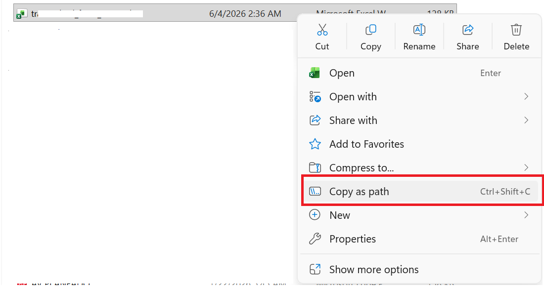

    • If you don't know your file path, you can open File Explorer > navigate to the folder you store the file > select the file and right-click > Copy as Path (or use short-cut Ctrl+Shift+C) > paste it to replace the "C:\Path\YourFile.xlsm" part
