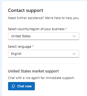

    For direct assistance, you’ll need to escalate through the official support channels. Verification issues are tied to backend systems, which can’t be resolved within a public user‑to‑user forum like Microsoft Q&A. Only Bing Places support can proceed further:
    1. Sign into https://www.bing.com/forbusiness/contactSupport
    2. Select your region and language (example below)
    3. Click Chat now and explain your issue.
    Overall, given the “unexpected error” message you’re seeing, there is a chance the issue is on the Bing side rather than your configuration. In similar reports, retries or waiting can sometimes resolve it without any change.
