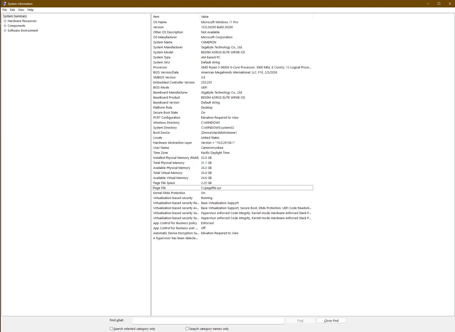

  3. Cameron 0 Reputation points
    2026-06-12T22:29:17.3733333+00:00
    Thank you for your response!
    Here is a screenshot of the system summary:User's image
  4. Sumit D - IA 170.7K Reputation points Independent Advisor
    2026-06-12T00:00:21.3866667+00:00
    It does point to a hardware defect, since the other GPU has worked and 117 error code directly indicates the GPU. Let us explore what we can do.
    Please supply the following Information.
    Right-click the Start button and Choose the Run option
    Type in msinfo32
    Press enter.
    Take a screenshot of the System Summary window and post it in the next reply.
    I look forward to your response and am eager to collaborate until we find a solution.
