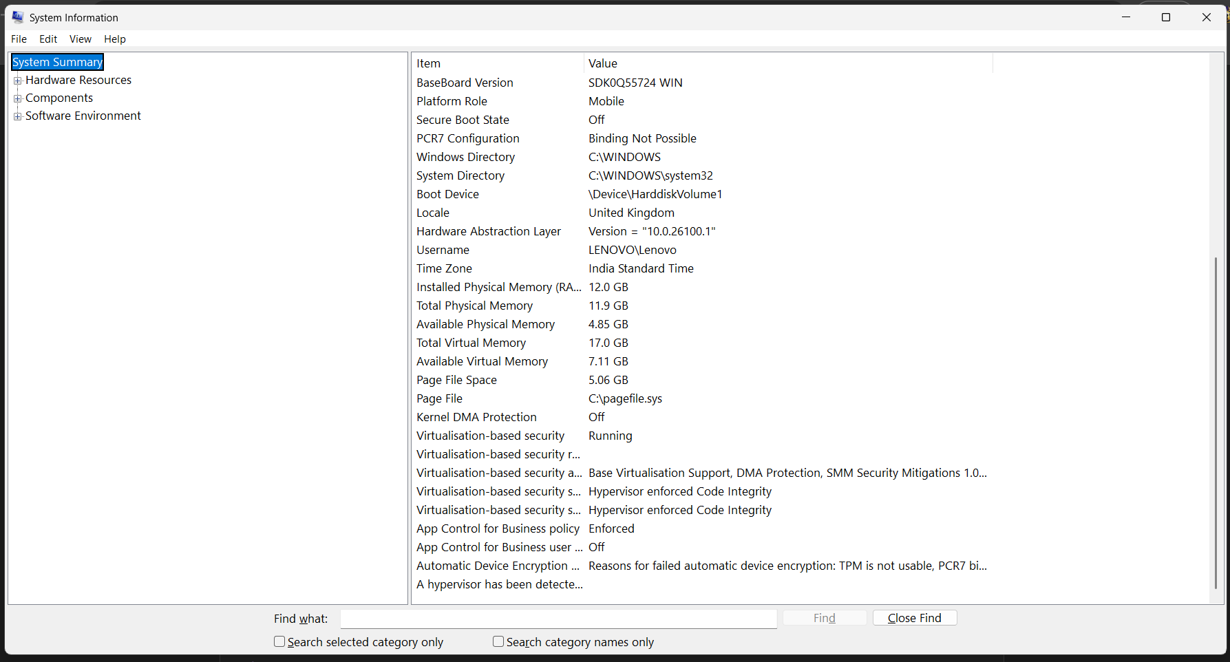

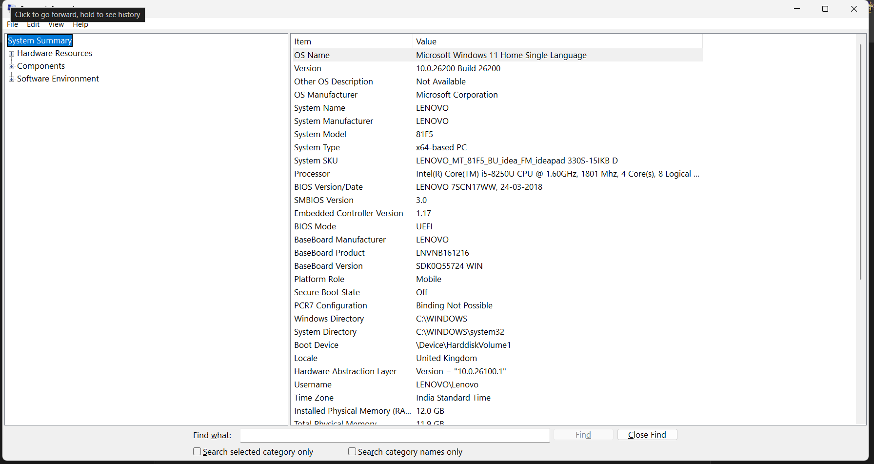

Click your Start Button, then just type msinfo and press Enter, please provide a screenshot of the resulting System Information window.
