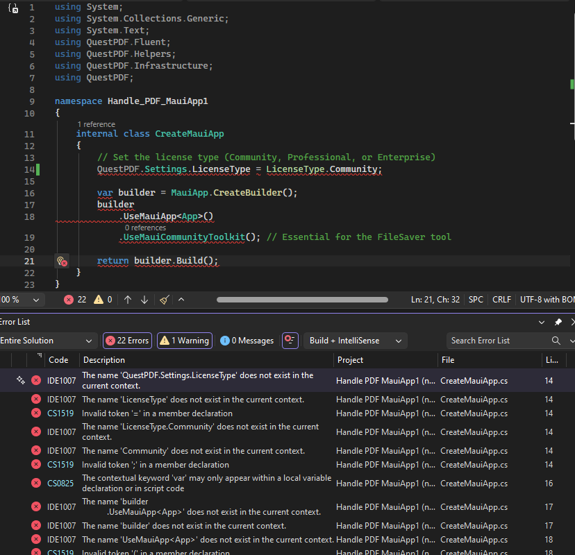

Jonathan 210 Reputation points
2026-06-17T05:27:33.4066667+00:00
Can you help for the issues below? I did the change to add "Type" but still the same problem.

I understand that you are still getting errors after adding Type for the QuestPDF license configuration in your .NET MAUI project.
From the screenshot, the main issue is that the code is placed directly inside the class body, but it needs to be inside the CreateMauiApp() method. Also, the QuestPDF license setting should be QuestPDF.Settings.License, not QuestPDF.Settings.LicenseType.
Please update your MauiProgram.cs like this:
using CommunityToolkit.Maui;
using QuestPDF.Infrastructure;
namespace Handle_PDF_MauiApp1;
public static class MauiProgram
    public static MauiApp CreateMauiApp()
        QuestPDF.Settings.License = LicenseType.Community;
        var builder = MauiApp.CreateBuilder();
        builder
            .UseMauiApp<App>()
            .UseMauiCommunityToolkit();
        return builder.Build();
Also, please make sure the .NET MAUI Community Toolkit NuGet package is installed in your project. Otherwise, UseMauiCommunityToolkit() will still show an error.
So the key changes are:
Put the code inside public static MauiApp CreateMauiApp()
Use QuestPDF.Settings.License = LicenseType.Community;
Make sure using QuestPDF.Infrastructure; is added
Make sure using CommunityToolkit.Maui; is added
Confirm that the CommunityToolkit.Maui NuGet package is installed
You can also refer to the official QuestPDF license configuration documentation here: https://www.questpdf.com/license/configuration.html
And the .NET MAUI Community Toolkit setup documentation here: https://learn.microsoft.com/en-us/dotnet/communitytoolkit/maui/get-started
