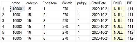

EchoLiu-MSFT 14,626 Reputation points
2021-10-19T06:56:23.793+00:00
Insert into tbl_BalPacM values (111,16,null)
alter trigger [mytriggerdel]
on [tbl_BalPacM]
after update
as
begin
if update (del)
   begin
   update a
   set a.orderno=b.orderno
   from tbl_PckDetail a
   inner join inserted b
   on a.pid=b.pid
   --  where a.DelID is null
   update a
   from Probale a
   inner join tbl_PckDetail b
   on a.prdno=b.prdno
   inner join inserted c
   on c.pid=b.pid
   --   where  b.DelID is null
   end
end
update tbl_BalPacM
set del=1
FROM tbl_BalPacM
where PID=111
SELECT * FROM Probale
You write del in the trigger as delid, I modified it to test that the trigger works normally.
Regards
Echo
