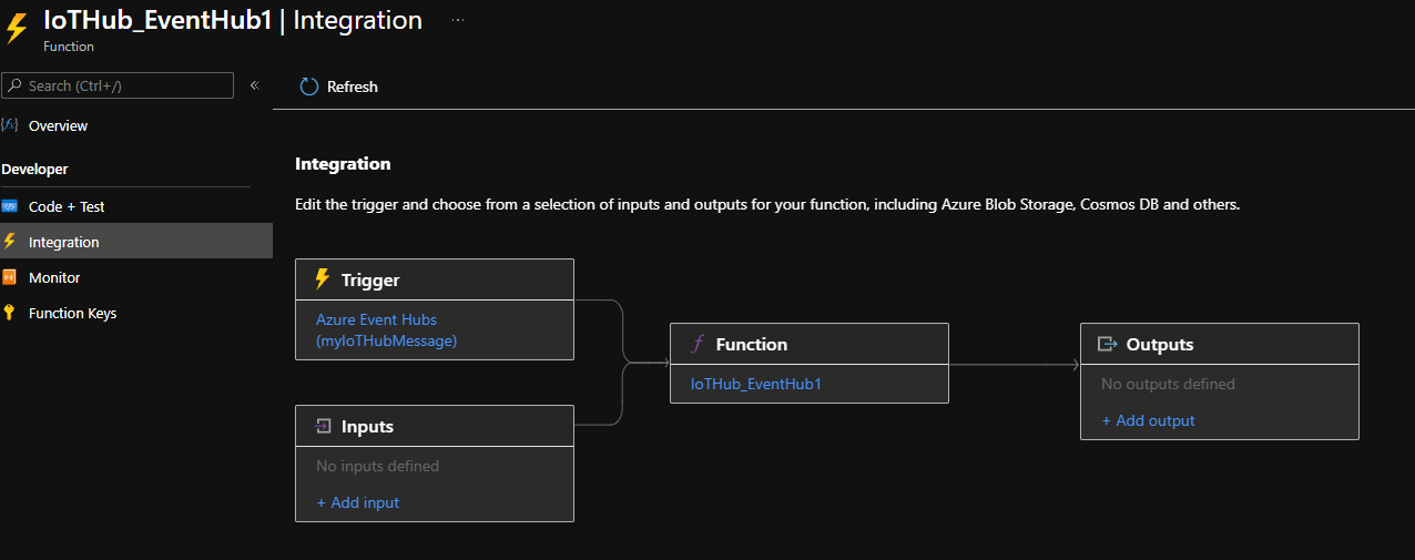

I add a "devel" deployment slot in the function app's portal. The target slot is my original "production" that I have been deployed to. I can deploy different code to "devel" and "production" via vsc. It seems that the "devel" slot has been executed when client connects to the function app. This is what I understand that the "devel" maps to target "production" slot. If I want the client to hit the original "production" slot, I can only "stop" the "devel" function app. Is there other way to choose which slot is facing customer? And what is the normal use case for the different deployment slots. Because if I want my real customer still hits the production slot while my test client hits the "devel" slot. If I turn on the devel function app, the mapping happens and my customer will hit to devel one.
My function app sits behind IotHub and triggered by builtin eventhub.

    By default, all the requests/triggers would execute the production slot's function, there is no need to stop the devel slot. Again, I would suggest you to check the client side or also take a look at the integration page of the Production slot's function app and check if the trigger and bindings section has been mapped to correct IOThub resource name
