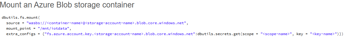

HI,
I am trying to make connection from azure blob storage to data bricks using mount point connection ,i am getting error,
can you please any one help me in resolving this error. please find my code snippet below.

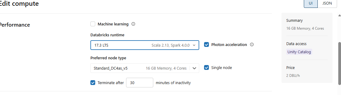

    To help determine the exact cause, could you please provide the following information?
    • Is your workspace enabled with Unity Catalog?
    • What is the Databricks Runtime (DBR) version of the cluster?
    • What is the cluster access mode (Shared, Standard, or Dedicated/Single User)?
    • Are you connecting to Azure Blob Storage (blob.core.windows.net) or Azure Data Lake Storage Gen2 (dfs.core.windows.net)?
    If your workspace is Unity Catalog-enabled, the recommended approach is to access storage using Storage Credentials and External Locations rather than dbutils.fs.mount().
    Once we have the above details, we'll be happy to assist you further.
