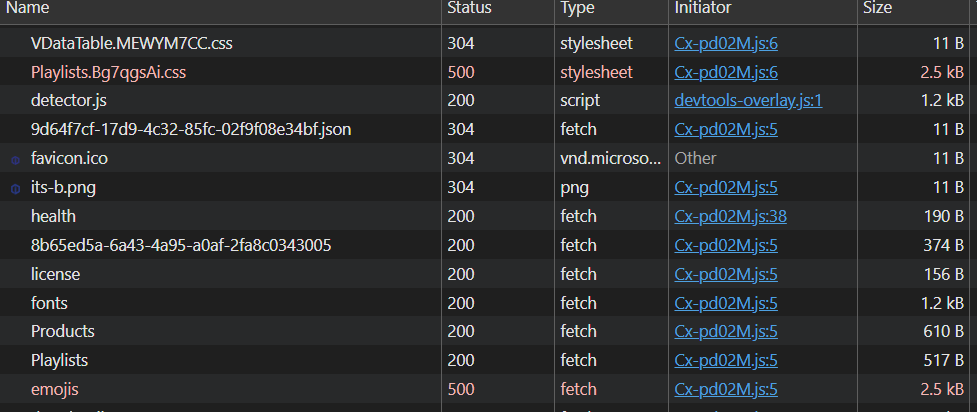

We have multiple static web apps in different subscriptions. This morning they all started return 500 errors for about 5% of all requests given to them. It appears random as to what request gets a 500 error. Some are for static content, others are for proxied backend API calls. They aren't consistent at all. All 500's are coming from "Azure Static Web Apps" and not from our backend. We don't use function apps.

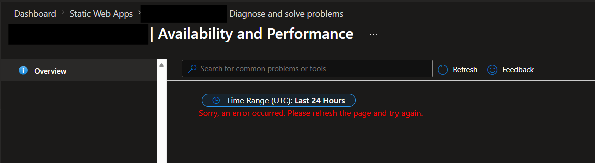

The "Diagnostics" page also returns an error when I try to use that
"Sorry, an error occurred. Please refresh the page and try again."

    From our investigation we found that Azure Static Web Apps platform issue (edge / proxy / routing layer).This was not caused by your application code, build artifacts, configuration, or backend services.
    • Errors originated from Azure Static Web Apps (confirmed via response headers and network traces), not your backend.
    • Failures were random and inconsistent, some requests succeeded, others failed for the exact same resource.
    • The issue affected multiple apps across subscriptions simultaneously and self-resolved, which is characteristic of a transient Microsoft-side platform glitch.

    Based on the pattern described, this is not a normal application-code or backend issue. The strongest evidence is that both static content and proxied API routes fail randomly, the backend is not producing the 500 responses, and the Azure Static Web Apps diagnostics blade is also failing. This points to an Azure Static Web Apps edge/proxy/platform issue that requires Microsoft-side Internal correlation.
