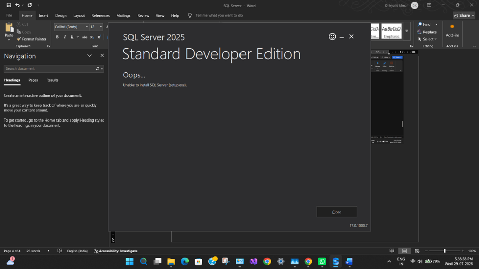

Hi Team,
I'm using the Window 11 OS and the Processor - Intel(R) Core(TM) i3-10110U CPU @ 2.10GHz, 2592 Mhz, 2 Core(s), 4 Logical Processor(s).
When i tried to install Microsoft SQL I was getting this error, please help me to resolve the issue.

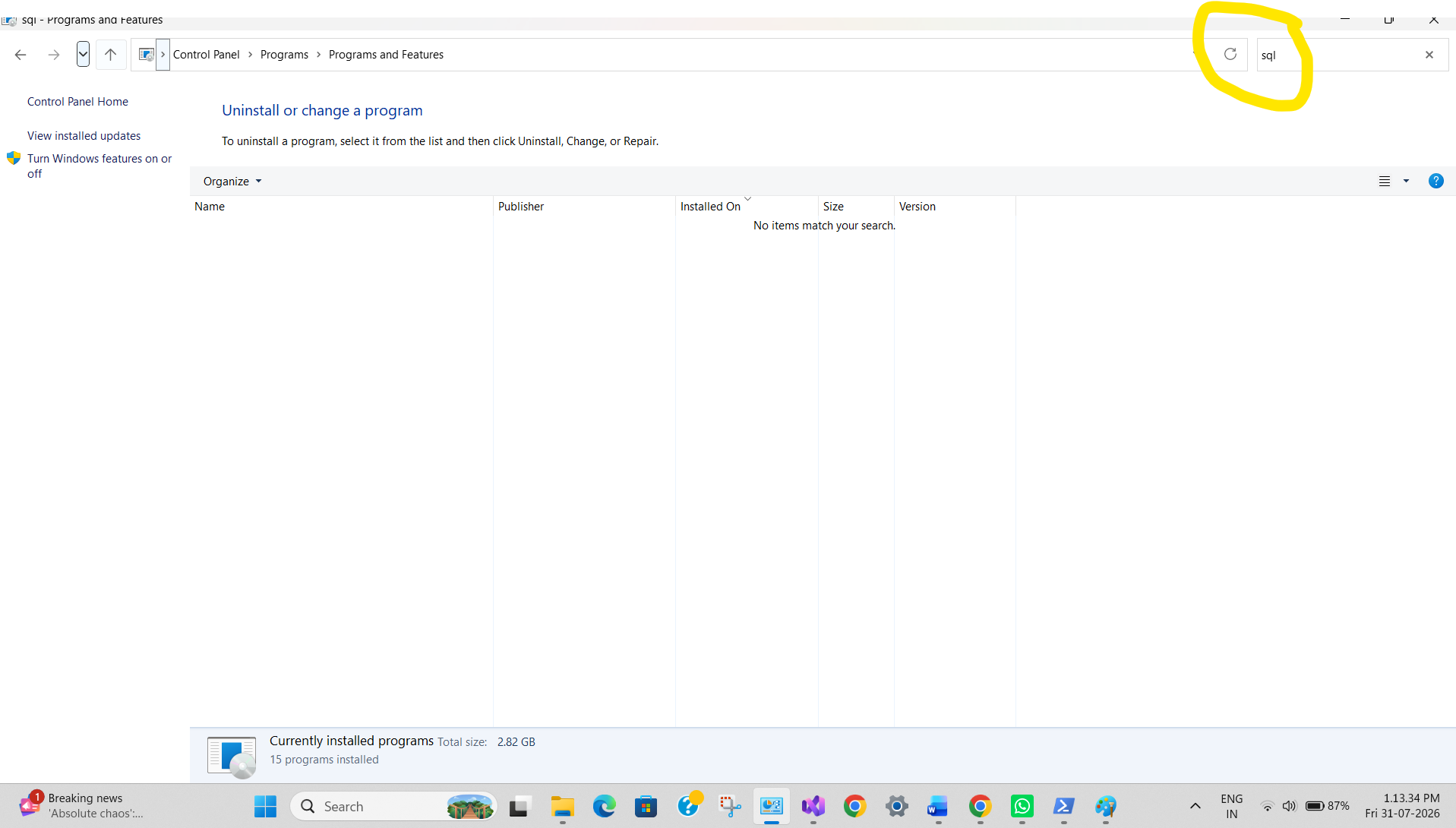

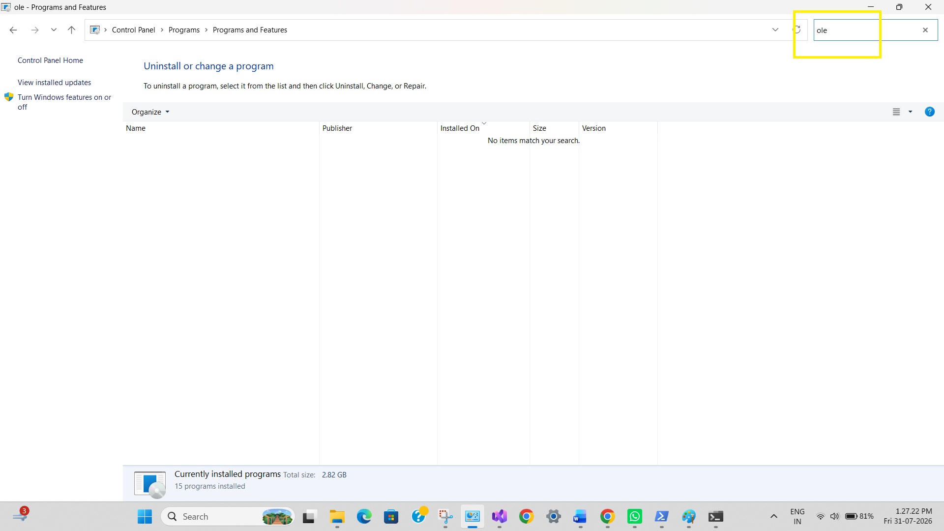

  1. Dhivya Krishnan 0 Reputation points
    2026-07-31T10:03:08.05+00:00
    1.     Uninstalled OLE
    2.     Uninstalled SQL
    3.     I downloaded everything will be shown
    4.     Rebooting the system,
    5.     Moved to C: drive
    6.     Installing msoledbsql as Adminstrator
    7.     OLE DB Driver installation is completed

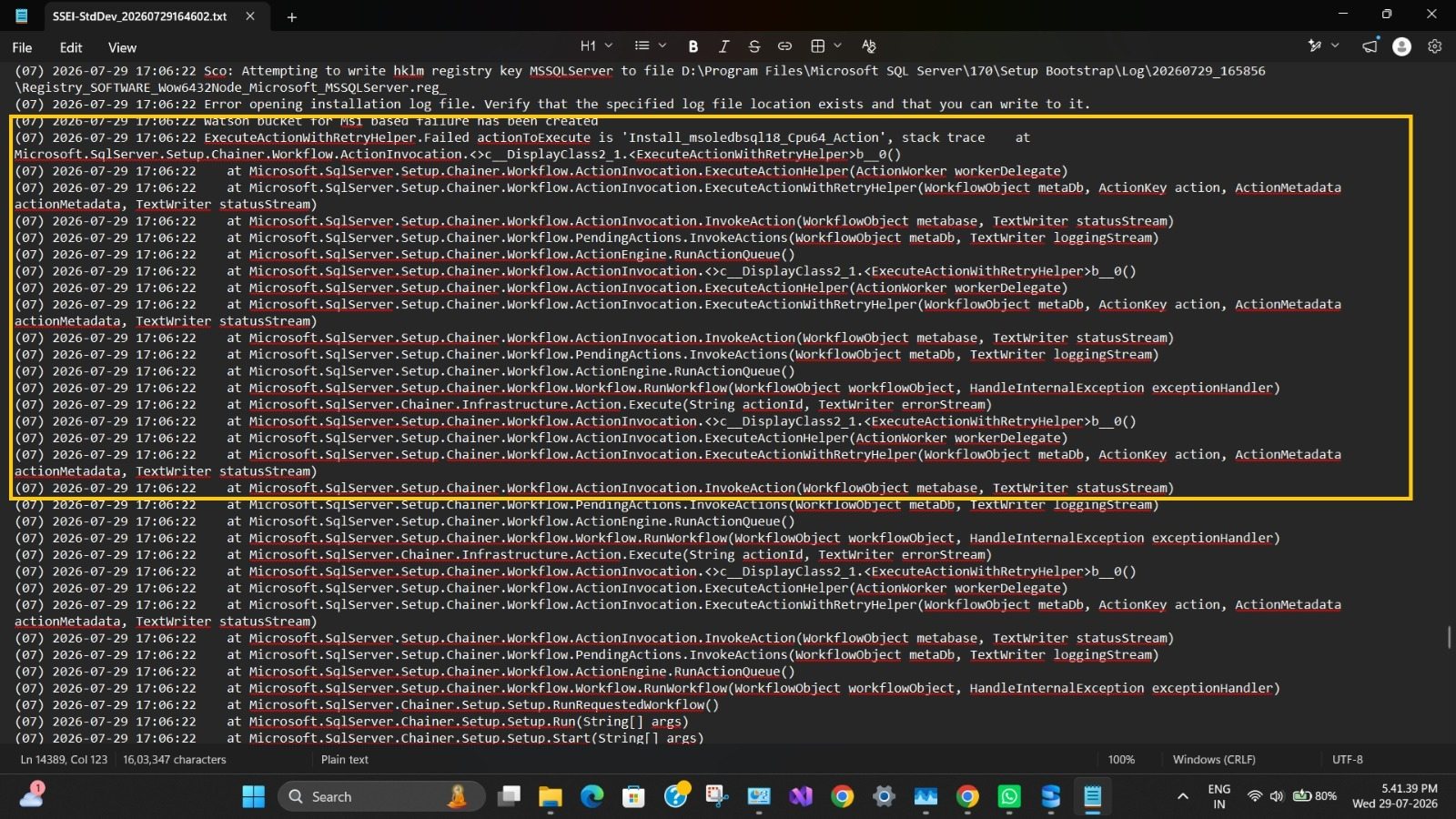

    When I checked the logs in the path “D:\Program Files\Microsoft SQL Server\170\Setup Bootstrap\Log\20260731_143622” I found the issue was
    (18) 2026-07-31 14:36:53 SQLArcOnboard: IsItAzureVM cannot reach IMDS, exception System.Net.Http.HttpRequestException: An error occurred while sending the request. ---> System.Net.WebException: Unable to connect to the remote server ---> System.Net.Sockets.SocketException: A connection attempt failed because the connected party did not properly respond after a period of time, or established connection failed because connected host has failed to respond 169.254.169.254:80
       at System.Net.Sockets.Socket.InternalEndConnect(IAsyncResult asyncResult)
       at System.Net.Sockets.Socket.EndConnect(IAsyncResult asyncResult)
       at System.Net.ServicePoint.ConnectSocketInternal(Boolean connectFailure, Socket s4, Socket s6, Socket& socket, IPAddress& address, ConnectSocketState state, IAsyncResult asyncResult, Exception& exception)
       --- End of inner exception stack trace ---
       at System.Net.HttpWebRequest.EndGetResponse(IAsyncResult asyncResult)
       at System.Net.Http.HttpClientHandler.GetResponseCallback(IAsyncResult ar)
       at System.Runtime.ExceptionServices.ExceptionDispatchInfo.Throw()
       at System.Runtime.CompilerServices.TaskAwaiter.HandleNonSuccessAndDebuggerNotification(Task task)
       at Microsoft.SqlServer.Configuration.InstallWizard.AzureDetailsHelper.<IsItAzureVM>d__5.MoveNext()
    (16) 2026-07-31 14:36:53 Slp: -- PidInfoProvider : NormalizePid is normalizing input pid
    (16) 2026-07-31 14:36:53 Slp: -- PidInfoProvider : NormalizePid found a pid containing dashes, assuming pid is normalized, output pid
  2. Deepesh Dhake 735 Reputation points
    2026-07-30T20:33:03.0566667+00:00
    The real error in your log is the last line: setup can't write to its log folder on the D: drive.
    Please try, in order:
    Confirm the D: drive exists and has free space. If it's missing, full, or read-only, that's your cause.
    Test write access - open Command Prompt as Administrator and run:
     echo test > "D:\Program Files\Microsoft SQL Server\170\Setup Bootstrap\Log\test.txt"
    Fails then it's a D: access/space issue (the root cause).
    Succeeds then D: is fine; likely admin rights.
    Run setup as Administrator, or point it to a writable path:
    setup.exe /INSTALLPATH="C:\Program Files\Microsoft SQL Server"
  3. Deepesh Dhake 735 Reputation points
    2026-07-30T18:02:58.14+00:00
    Your setup is failing on the step that installs the OLE DB Driver 18 (Install_msoledbsql18_Cpu64_Action). The most common cause is a newer version of that driver already being on the machine.
    Please try this in order:
    Uninstall existing OLE DB drivers - Control Panel then Programs and Features then remove any "Microsoft OLE DB Driver for SQL Server" (18 or 19), then reboot.
    Run setup as Administrator (right-click then Run as administrator). SQL 2025 will reinstall its own driver cleanly.
    If it still fails, check the real cause here:
       findstr /S /I /C:"msoledbsql" /C:"return value 3" "D:\Program Files\Microsoft SQL Server\170\Setup Bootstrap\Log\20260729_165856\*.log"
  4. AI answer
    2026-07-30T17:17:47.64+00:00
    The screenshot shows the SQL Server installer failing very early with "Unable to install SQL Server (setup.exe)". The log snippet also shows a write attempt to the SQL Server setup bootstrap log path. On Windows 11, the supported path depends on the SQL Server version, and the next step is to identify the exact setup failure from the setup logs.
    Use this path first:
    1. Open File Explorer.
    2. Go to: C:\Program Files\Microsoft SQL Server\170\Setup Bootstrap\Log
    3. Open the latest dated folder.
    4. Check Summary.txt and Detail.txt / Details.txt.
