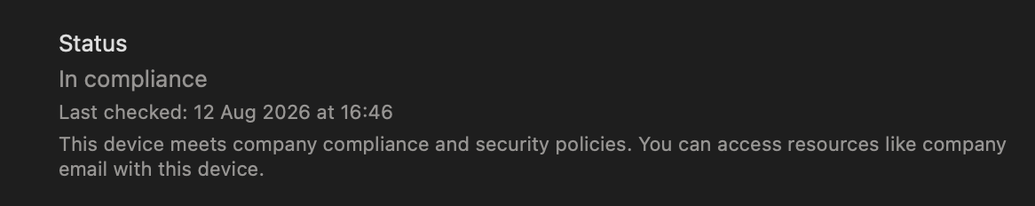

I can onboard the device successfully, but when I try to logon from the browser, I get error code 530003, i have Microsoft Enterprise SSO extension installed and company portal installed in Status is In Compliance. Work Profile is also successfully logged into:
Error code: 530003
Timestamp: 2026-08-12T13:49:58.403Z
App name: One Outlook Web
Device identifier: Not available
Device platform: macOS
Device state: Unregistered
Screenshot 2026-08-12 at 16.52.46
